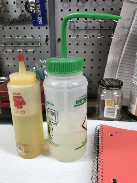

AFB carb fuel bowls are well vented and modern gas is highly volatile. It will be half evaporated within 3 or 4 days in most circumstances. I always prime mine with a ketchup bottle through the vent tubes and dribble a little down the throat. Or you can first spin the motor without touching the gas pedal for 2 or 3, 5 second spins to fill the bowls and then pump the throttle 2 or 3 times and spin it to start.
