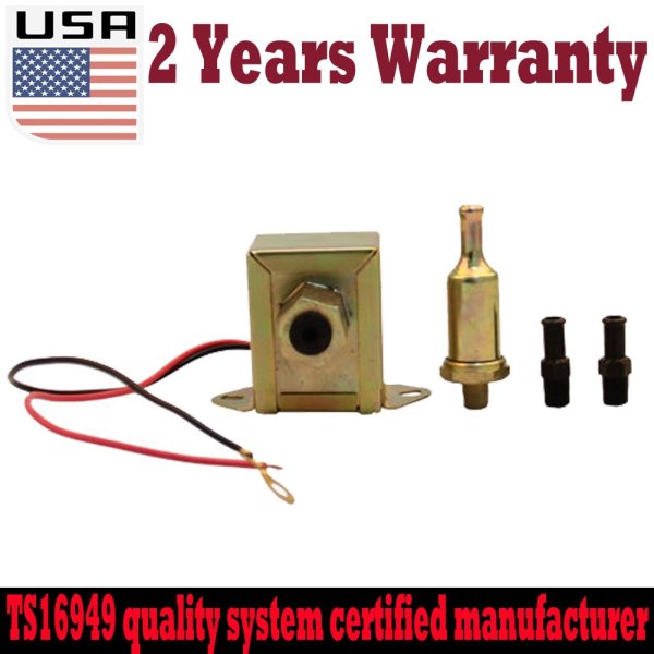

Add a Facet 60301 electric pump in the fuel line back near the tank... Set it up with a momentary contact push button switch... fuel can flow through it when the pump isn't running so it only needs to run to prime the carbs.... It puts out 5.5PSI so it won't push fuel past the needles like a 7-8 psi pump can....
Says 1/8" NPT in and out on that one though?
All the Facet pumps are 1/8-NPT no matter what design... They work, period...
If your concerned it won't flow enough fuel you can add a bypass with a check valve... But it doesn't need it unless your making serious (550+) HP...

He needs to fill the carb bowls through the vents and it will start and stay running. It sounds like most of the gas has evaporated from the bowls. I would install a electric priming pump on a momentary switch and his issues will be over. Here's a link for more information. Electric primer pump for fuel

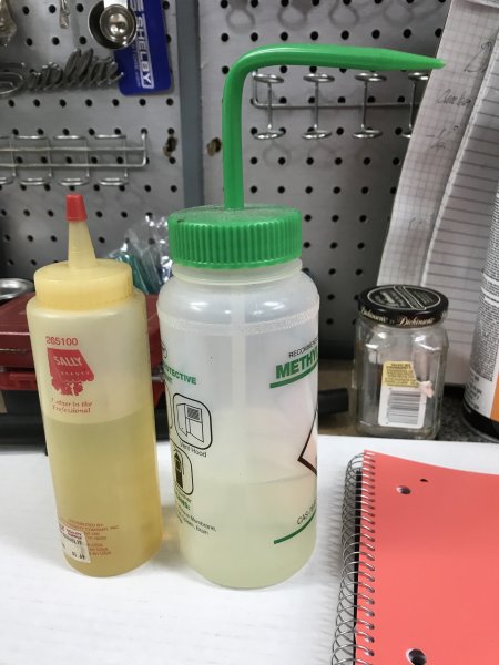

Yes, that is how I start mine. I use a bottle to squirt an ounce or two of gas in both bowls and then dribble a little down the rear carb primaries and it will kick off and stay running. I gave him a squirt bottle finally and I think he’s having a little better success with it.
AFB carb fuel bowls are well vented and modern gas is highly volatile. It will be half evaporated within 3 or 4 days in most circumstances. I always prime mine with a ketchup bottle through the vent tubes and dribble a little down the throat. Or you can first spin the motor without touching the gas pedal for 2 or 3, 5 second spins to fill the bowls and then pump the throttle 2 or 3 times and spin it to start.
