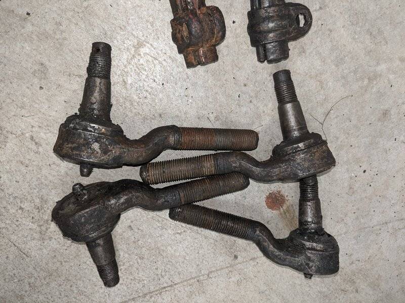

- should I replace Tie Rod ends and sleeves? Just ends? Or use existing with new boots? Assuming replace only the ends.

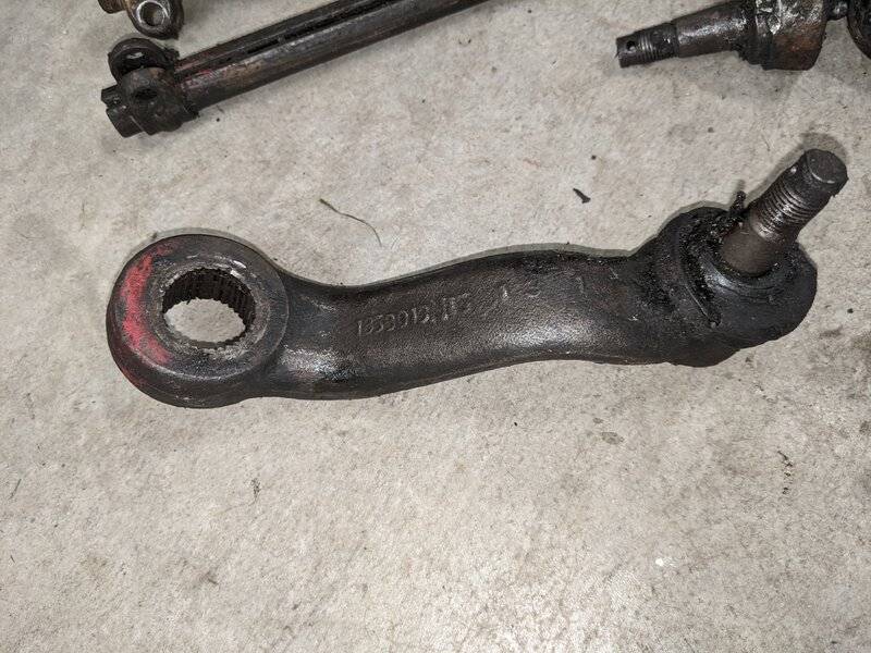

- same with Pitman arm? Assuming replace.

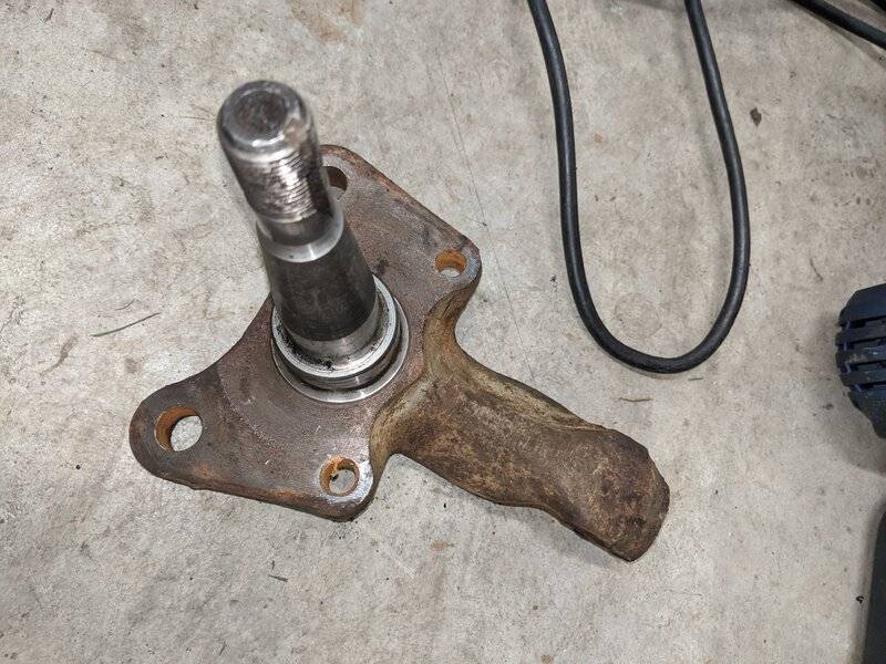

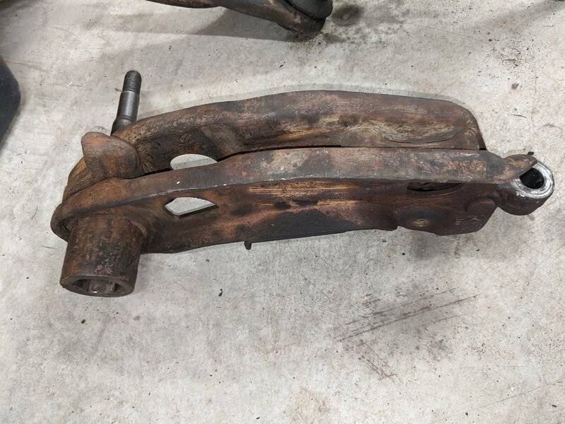

I've been using as much Proforged suspension stuff as possible, and have been happy. One thing they don't make yet is the offset upper control arm bushings if you are going that route. Moog has been getting a bad rap lately for poorer quality than it used to have. You will need new spindles if using Dr Diff's disc conversion. There are some kits that do use the factory drum spindles with their disc conversions however. I have also been upgrading the tie rods and adjusters to the bigger 11/16" C-body parts. PST sells stiffening plates for your lower control arms that work well also.
Are those tie rods worn out? what about the pitman? or idler? old OE parts that are NOT worn out are better that NEW chinneese parts any day. replace whats worn out and keep the rest. as far as clean and refinish do what you want. Is this gonna be a 100 point show car? or you just want a reliable ride. Replacing parts just to replace parts makes no sense to me. If they're good they're good Thats my take

I too upgraded to front discs from Dr. Diff. I left them manual, but replaced all the lines and the MC. And, like Elk said, you will need Dr. Diff's spindles.

Not 100% sure how to tell if the tie rods, idler arm and Pitman are still good...

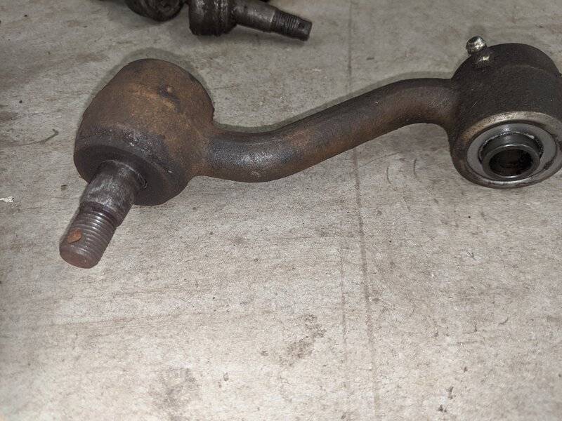

The idler arm seems fine, no slop and can't move it at all.
Pitman arm has torn boots and I can move the joint by hand.

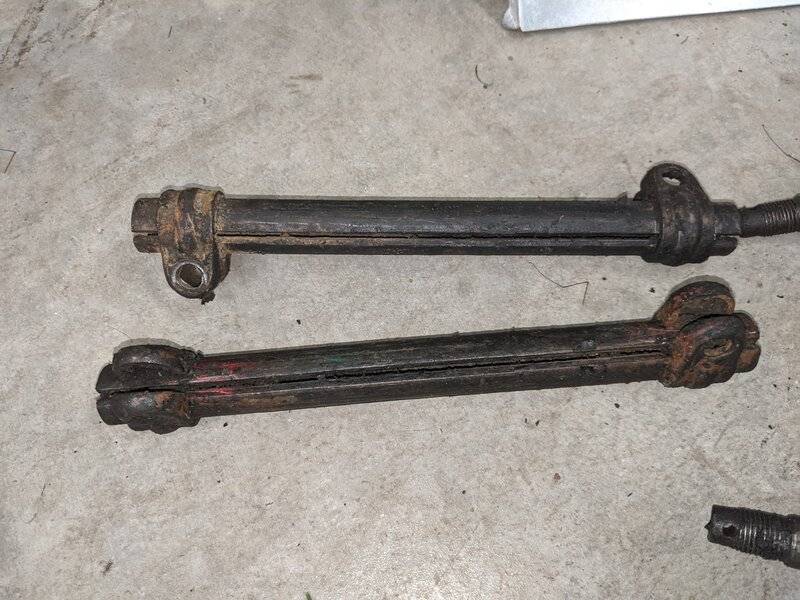

Likewise with the tie rods.

using C body tie rod end to replace the stock B body ones is a good upgrade if you are using larger front tires on your car. C body tie rod ends has a 11/16 inch diameter shank which is TWICE as rigid as the B body tie rod 's 9/16 inch diameter shank. I do it on all my B body cars I've had.

using C body tie rod end to replace the stock B body ones is a good upgrade if you are using larger tires on your car. C body tie rod ends has a 11/16 inch diameter shank which is TWICE as rigid as the B body tie rod 's 9/16 inch diameter shank. I do it on all my B body cars.

Larger tie rods are much stronger than the 9/16" ones that came in the car and are a direct swap. The stiffening plates remove any sloppiness in the lower control arms, and are cheap and easy to install. I also use PST 1.03: torsion bars in all my cars.

yes they will bolt right up. You will have to buy the C body 11/16 inch adjusters to, I use aftermarket billet aluminium type adjusters, they are stronger then the factory type C body adjusters

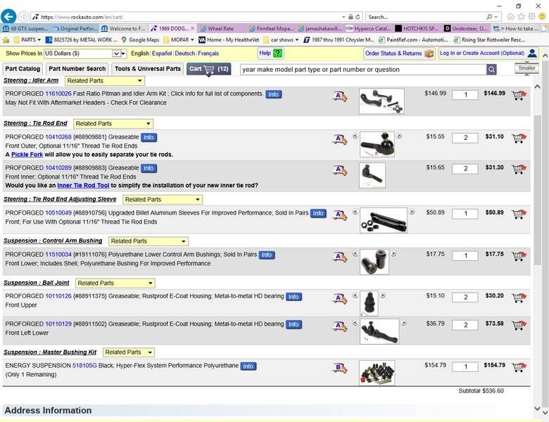

Here is a sample order for Rockauto that I would do. It includes fast-ratio Pitman and Idler arms that will give you better steering response.
I would replace everything in one shot. I don't know if you're handling the labor or paying someone else to do it but doing a job once and being done with it is the way to go!
