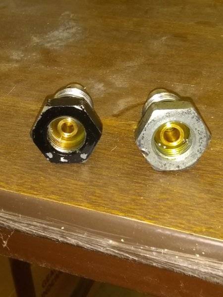

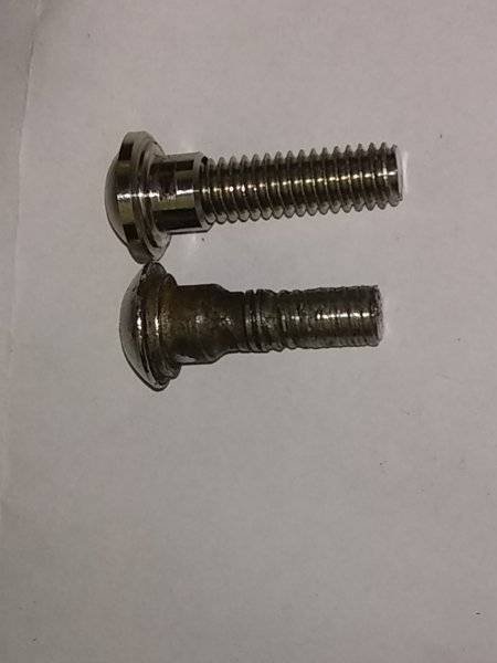

Comparison of studs.

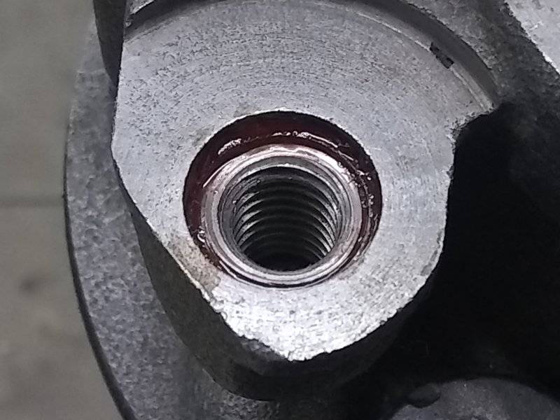

So I got the insert out cleaned up the threads with brake clean. Then used locktight to secure it.
In and set to depth for the oring. I then ran out of the shop before anything could go wrong!

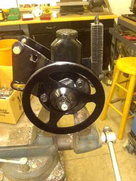

I got the pump reassembled. I'm going to plug the lines and fill it and see what happens before I install it. Fingers crossed.

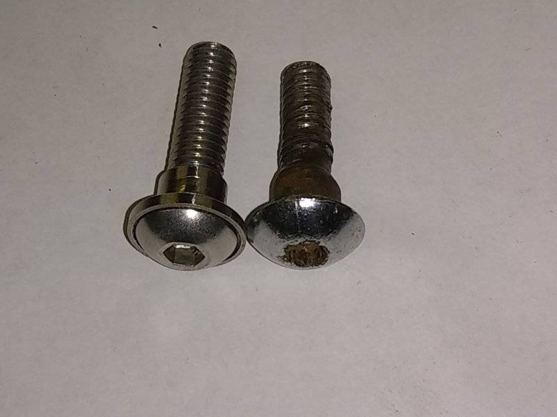

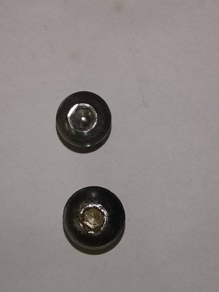

So my buddy seat pivot bolts were crappy, and I wasn't having any luck finding a set sooooo.

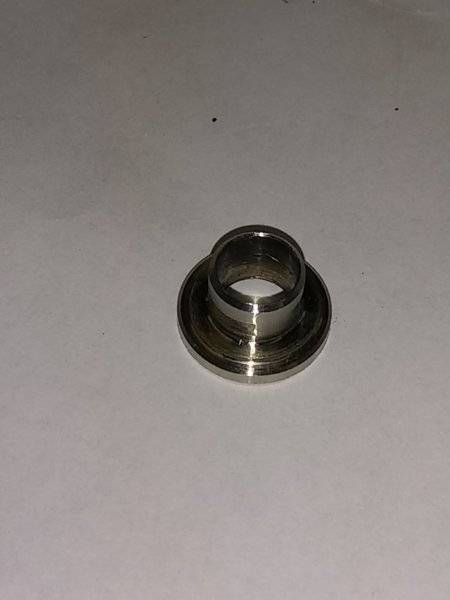

I took a 5/16 SS button head bolt and made bushing to simulate the step, and shoulder.
These should work. I made a couple extras if anyone needs a set.
I put power steering fluid in the pump to check for leaks.

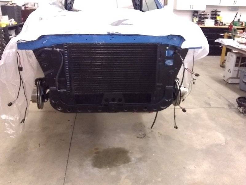

Then I noticed a missing cotter pin on the outer tie rod. So I went through them all torqued them and installed cotter pins. Next I blacked out the header panel. A fairly productive afternoon with no drama.
Then I noticed a missing cotter pin on the outer tie rod. So I went through them all torqued them and installed cotter pins. Next I blacked out the header panel. A fairly productive afternoon with no drama.View attachment 928693

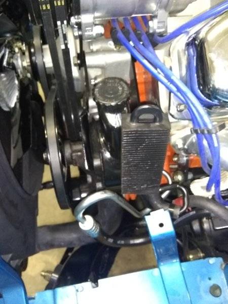

So the pump sat and didn't leak so thought I would install it. Took 2 times to get the pulley where I liked it. I was thinking I had it whipped but it had one more kick to the nads left in it.
The dam thing had the wrong threads for my hose! Luckily I saved the old one from the core I sent in.

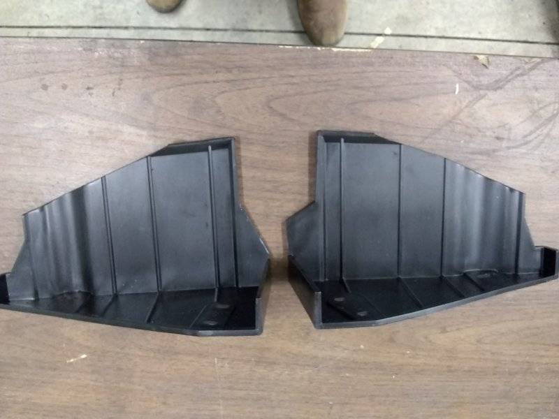

So I spent a couple days cleaning up the garage. Getting reorganized. I now have a empty table & bench. I did get the k member splash shields on. I did have to modify them just a little to fit around the adjustable struts.
