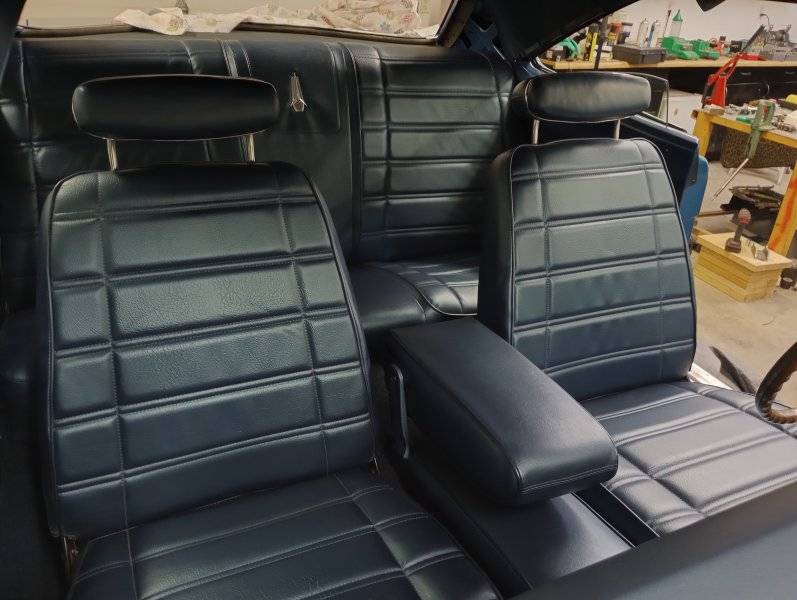

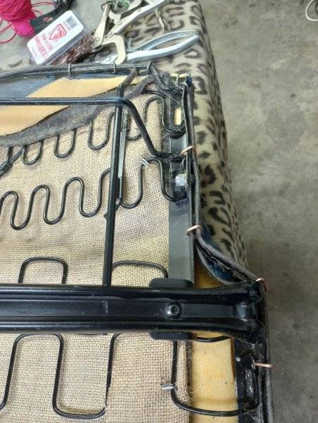

Got the lower back seat frames done finally. New hog rings are copper colored.

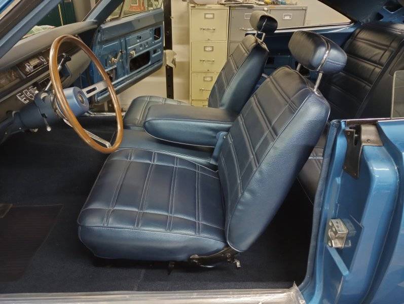

I had to raise the back seat up a little then I was able to get the bottom seat in. Got the front buckets assembled and installed too. Now it's starting to look like a car! I did slide in the driver's seat and boy did it bring back some memories! And a big smile.
Awesome! And you will have a bigger smile yet when you take it out and drive it when it is finished - keep this last push going and it will be done before you know it! :thumbsup:

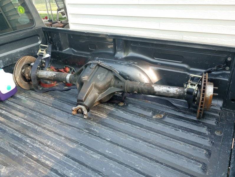

Dana is going to the shop Monday for front pinion seal and a checkup. I bought it used, so I don't want any surprises when I take it for it's first drive.

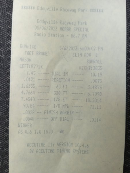

Went to Eddyville for the Mopar race yesterday. Entered 3 classes with the tow truck, got runner up in Mopar Street. Broke out by .0034! Some nice cars there.
My best package of the weekend and still got beat!

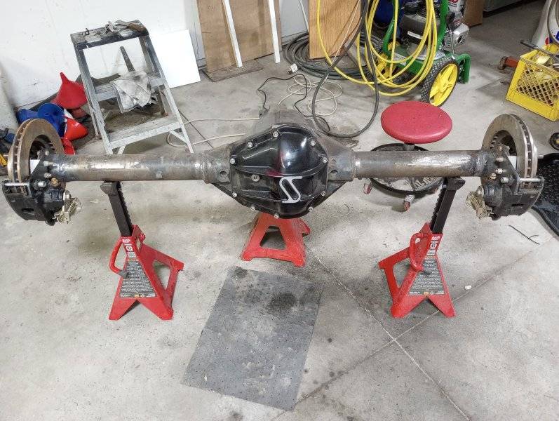

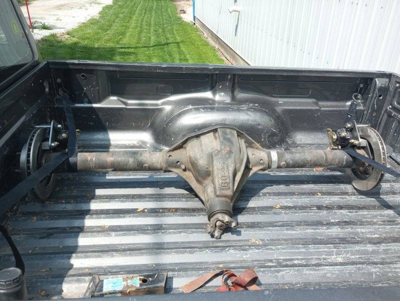

I'm to old to lift a Dana 60 anymore, by myself, into a truck!
Got the Dana back and all good. Started cleaning it so I can locate spring perches.

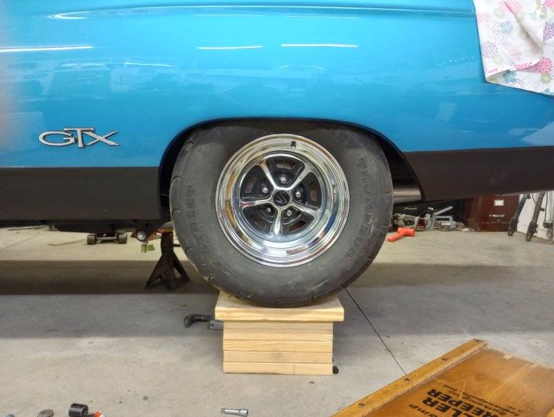

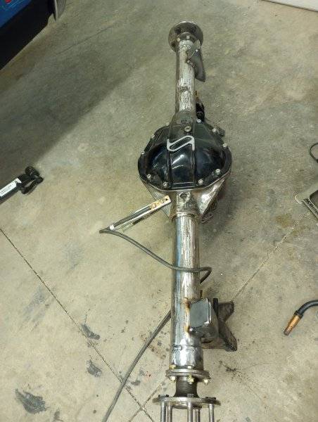

I'm going to weld tomorrow. Called Cal Trac and they said 2-4° down. Mike recommended 3 down so I'm going to set it at 2.5° down. Picture is with 200 lbs in trunk to simulate full gas tank, spare, & jack in trunk. 22" ground to top of wheel opening.

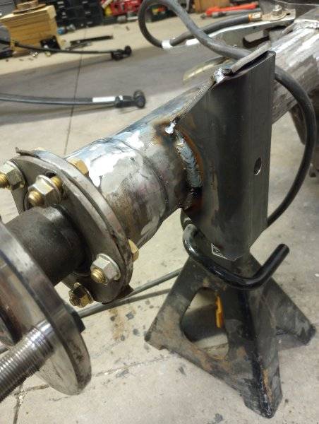

Triple checking. Looks like drive shaft might be close in tunnel at back. But I'm going forward, I have a lower hole at the front leaf spring hanger if I need to raise the car a inch. Welding up perches and boxing them in. Should be ready to paint first thing in the a.m.
Welding in short lengths to avoid warping the axle & boxing perches.
Finally!
