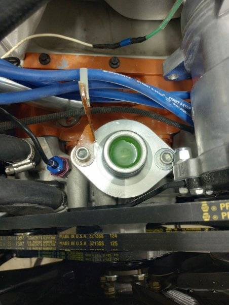

So did a second fire up today to run it up to temperature. I have a 180 thermostat in it. It continued to climb past 180 and I shut it off at 200. I pulled the thermostat and tested it. It opened but very slowly. So I have a 165 coming. It also didn't have the bleed hole. I'll make sure the 165 does. I did put the tranny in D & R and spun the wheels to get atf in the converter. I'll fire it up again tomorrow.
Replaced thermostat, drilled a .030 hole in it to avoid air pocket. Worked great. Took it off the stands and drove it down the street. Big milestone.
I use a 160 thermostat but the engine runs at 175, which isn't really abnormal. If your GTX still runs too hot after swapping the thermostat there's other issues with your cooling system or the tune up...
It has stayed at 170 so far, but don't have 90° temps right now.

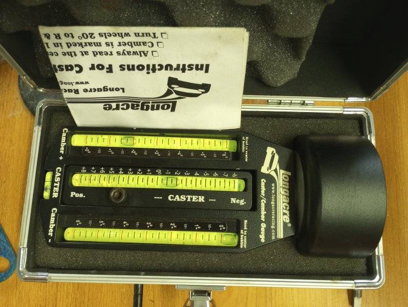

Yesterday I got the frontend aligned using a friends gauge. -1/2° camber
3.5° caster

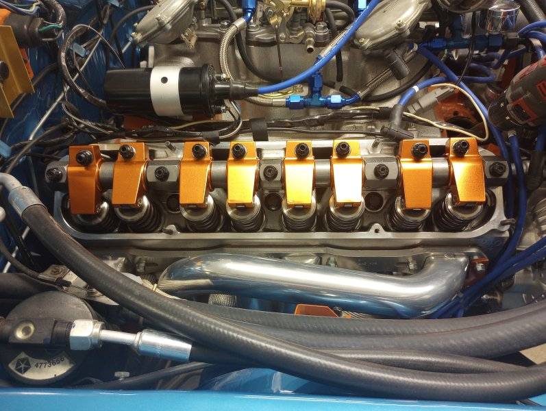

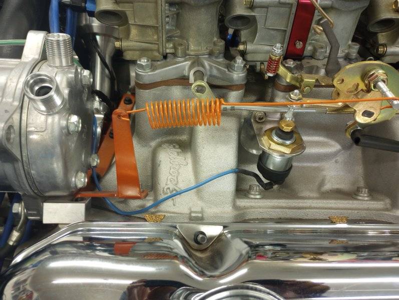

I double checked valve lash. Had one out .003 all others within .001. Tomorrow I'm going to run a wire to idle solenoid, then start hanging the front end sheet metal

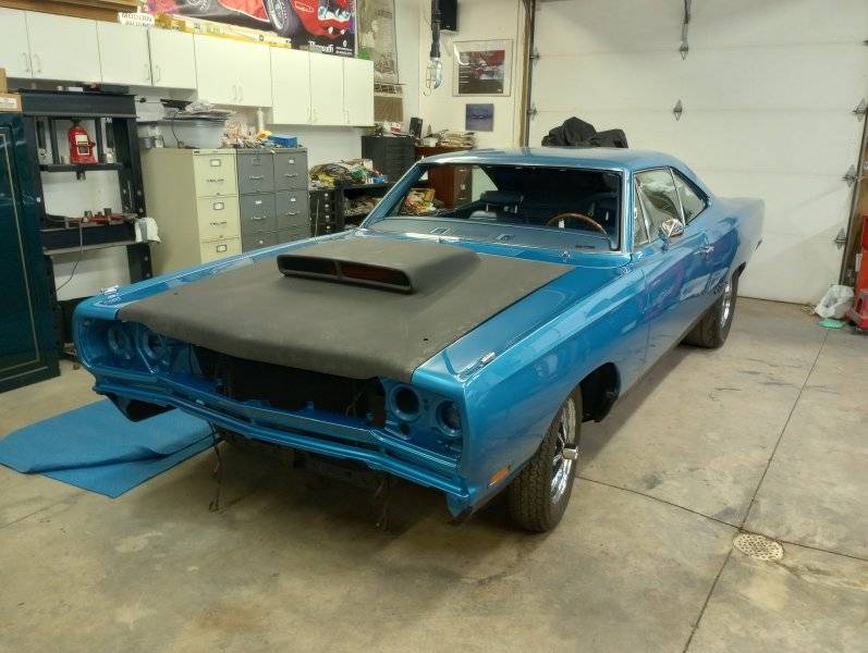

So I'm putting the sheet metal back on next. Have a appointment with Noel to get the front & back glass & vinyl top on come December. Can't wait!
