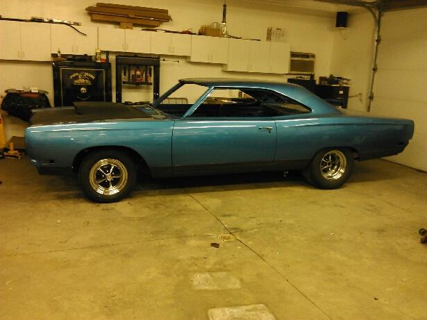

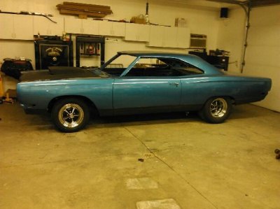

For the first time in a couple years the GTX is back on all 4! IMG_20160313_135147 (2).jpg
I have most of the front suspension in and brakes. I went with the /6 torsion bars and it feels pretty loose, what I was hoping for. I do have a set of small block bars if I need to change them. Rake is just how I want it, front is 1" lower than rear. I'm hoping everything will settle 1-2 inches after everything is in the car. I'm hoping rear wheel opening lip will settle right above the rim. And the front fender lip just below the top of tire.
