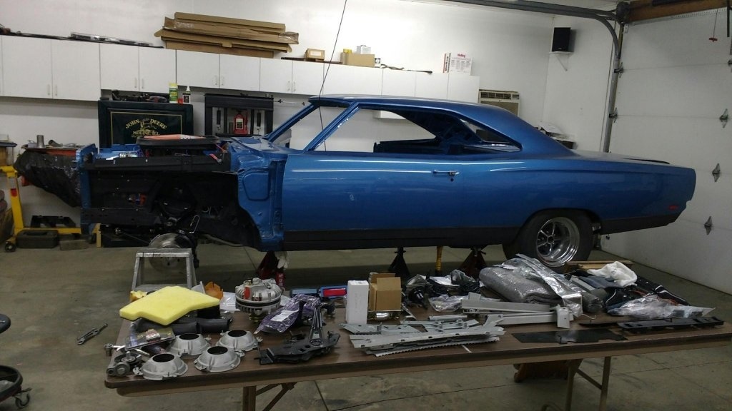

Well I really didn't get anything done on the car over the weekend, but I did get a lot of cleaning & organizing done so I can get started. Having a guy come and detail it at it's current state to get all the dust & compound splatter removed so I can start putting a cover on it. Amazing the dust that shows up even in a controlled environment. More cleaning tonight to get the "parts" tabled cleaned & organized!

Going to set up another "parts" table, so I can get the other one cleaned off & orginized. Looking forward to getting back at it.

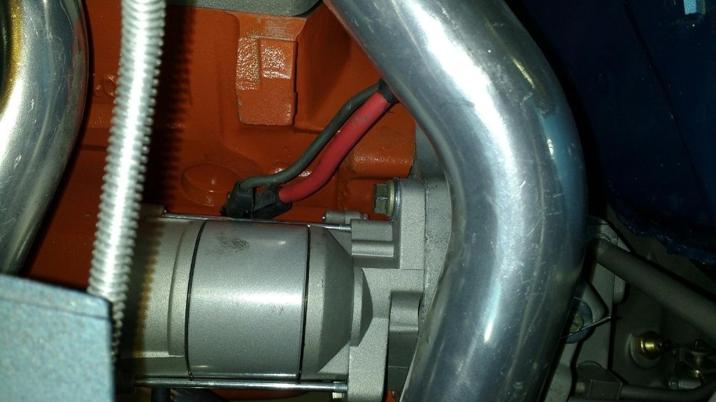

I got some time on her over the weekend. Worked on the battery cable from the starter. I had to remove the original extension piece because of interference with the block. After the engine was installed I couldn't get to the terminals so I pulled the starter again and loosely installed the cables the put the starter back in. Luckily I don't have the steering column in so I could sneak it in through the headers. Got it in place and tightened down the cables. This picture was taken through the access hole in fenderwell.

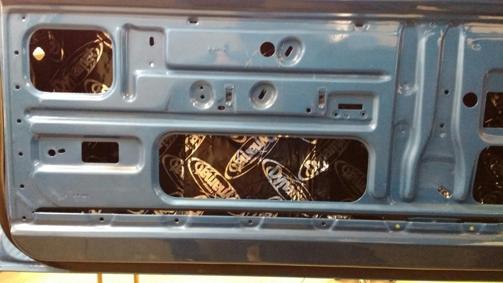

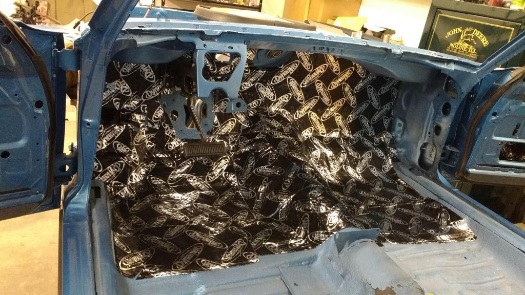

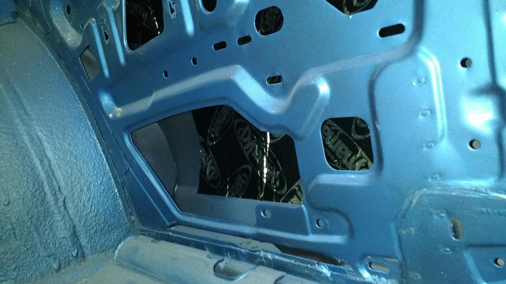

Also got the dyno mat under the dash, inside the doors, and quarter panel.
I bought a roller to roll the mat yesterday so I'll be doing that tonight. Between the 3 layers of Lizzard Skin and Dyno mat it should be pretty quite & insulated. I'll install the factory insulation over the top of this. The Hot Rod Power tour is coming through my state in June so I gotta get after it if I'm going to make that!

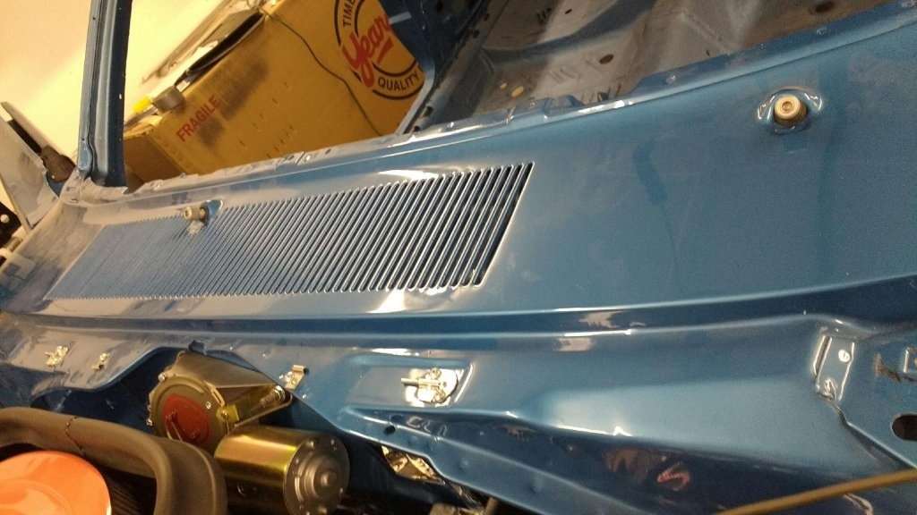

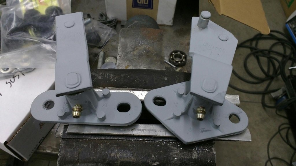

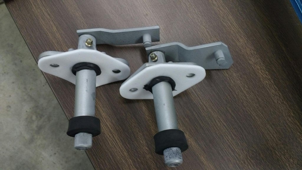

So I got a little time last night to work on the car. Installed the schumaker gasket set on wiper pivots. When drilling for the grease zerks be careful. When you get to yellow shavings your going through the bushing. Once I could just see the shaft I quit, you only need a small hose for the grease to go through. Also instructions say to wait 2 hours after installing the black water seal in housing to allow it to relax before installing. I had to reorder the clips for the linkage as they were really brittle and shattered when I tried to put them back on. Got a set from Mega Parts coming. Also installed the windshield washer squirters. I had to bend more curve in them to get them pointed up between the cowl slats. Got them from Mega also. PS they took very little grease to fill before coming out the bottom.
