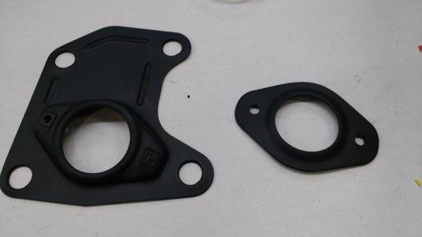

Retaining plates for column blasted & painted yesterday.

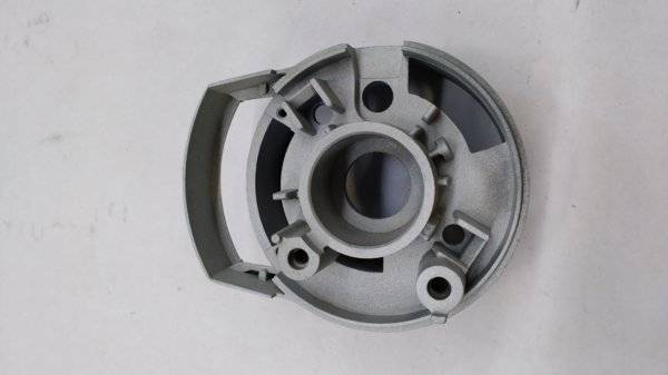

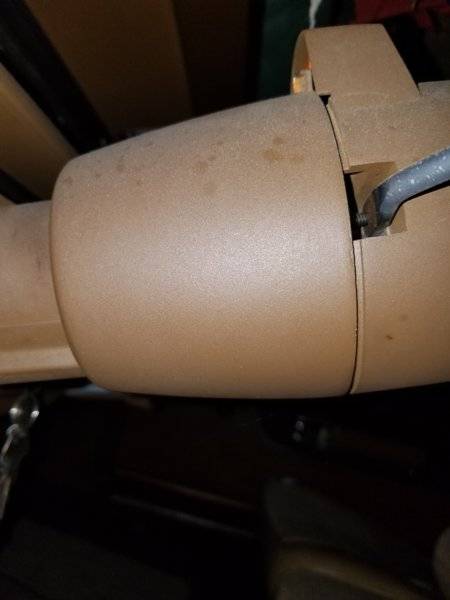

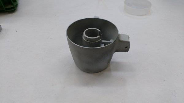

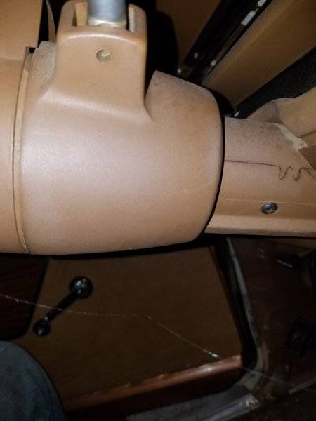

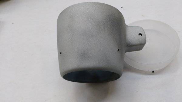

Got the selector hub/cover blasted. I'm thinking the 2 holes are what someone put there to hold the hoseclamp that probably held the Sun Super tach in place. Can anyone confirm these aren't factory holes? Also still looking for a very nice gear selector lever.
I looked back at the pictures on page 14 of my build and could not see those holes on my column from the angles that I have. I'm not close to my car to double check though.

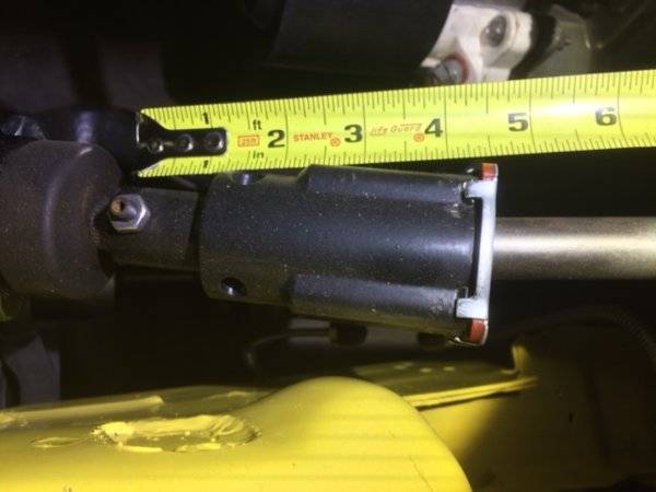

Here is a picture of my steering coupling. Let me know if you need another view.
Thanks Sherman! I'm thinking if I get another coupler and cut 1" or so off and weld it to another, bingo! Looks like they just did the same thing!
