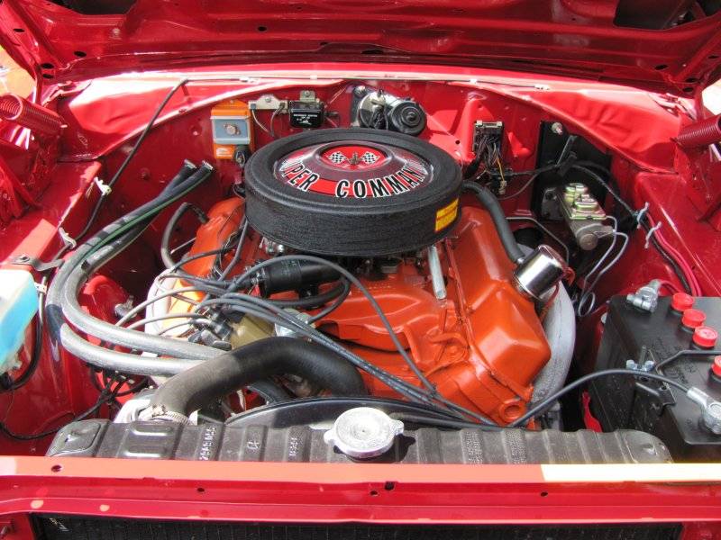

If you are trying to duplicate a '68 to early ''69 440 Plymouth (GTX), it's a red "super commando 440." Late '69 switched to the same with orange background. Red ones are cheaper.

If you've got the 383 aircleaner, you could use the top part, put it over a drop base to get more underhood room, and get a 440 pie pan for it.....but you won't fool anybody who knows there was no such thing from the factory.
A ‘69 GTX 440 air grabber base with your same kid will fit (air grabber hood or not)
That's a six barrel all right...... but not a 69. (69 A12 used a bathtub a/c base, and didn't use the coyote Duster decal)

Yea this is the one off my 383 that I just set on there for a pic. I ordered a chrome pie pan and will go with that.

There are always exceptions to the “rule”. My ‘69 GTX 440, that I bought, in original condition from the original owner in ‘78, has a red pie pan and a scheduled build date of 06/04.
My fifth one, scheduled build of 07/02 had a red one as well. It's the car pictured in post #2. St. Louis built car. I read about the orange being a mid '69 transition, but I haven't seen positive proof on an unrestored '69 GTX, at this point.
There is absolutely no question that my red one is original. I bought the car from the original owner, unmolested and I’m still in touch with him. Mine is a convert, so it’s also a St. Louis car.
I've owned four '69 GTXs, with build dates from extremely early, to extremely late, and observed differences between the first run, and later cars. The air cleaner color hasn't been one of them.
