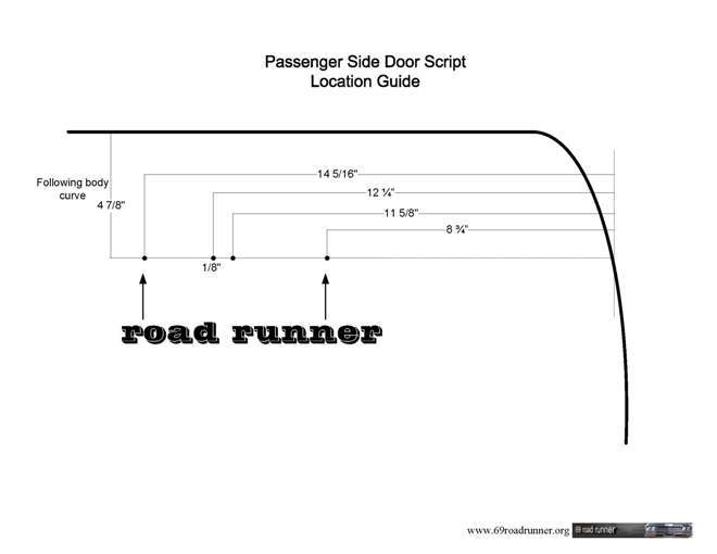

Anyone know where I can get the right measurements for the door emblems on a 69 roadrunner??

Off of my car. I'll try to remember to get the measurements tomorrow.
I ma guessing that the 1/8" dots are the locations for drill holes, Passanger door, Do you have data for drivers door ?
