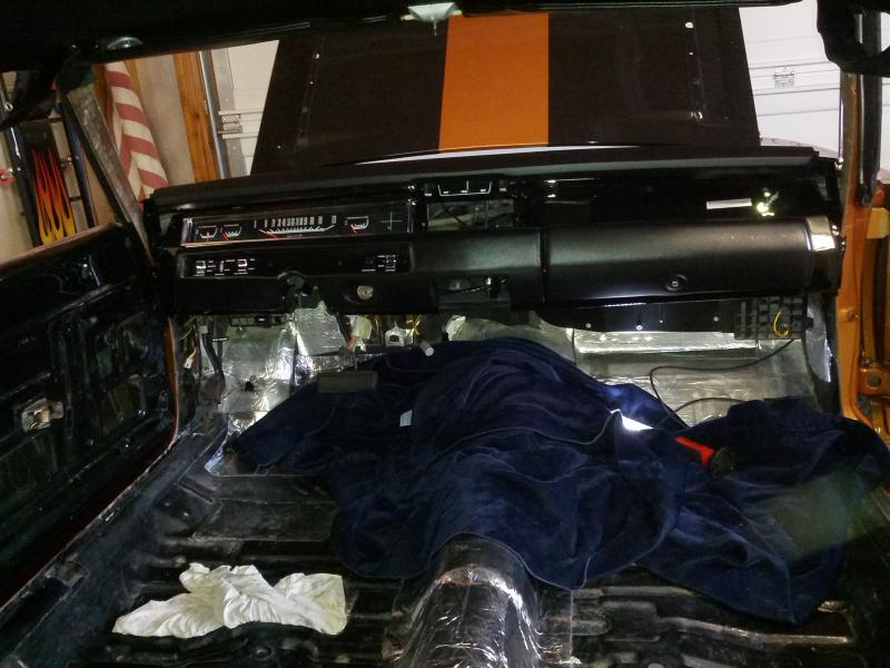

Because it allowed easy access to the dash retaining nuts on the right side.
