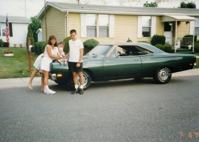

I have owned the car since...1989, and it was my very first car. I drove it in high school, terrorizing the parking lot and setting records for most number of school buses passed in a row :)
This is what it looked like in 1991..

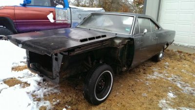

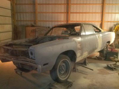

I hope to provide updates to this thread along the way. The pic below is sitting at the bodyshop waiting to go in to the garage.
Thanks!

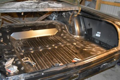

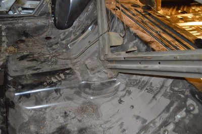

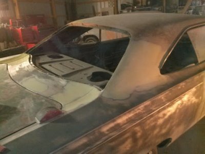

So its been a little over a year since i added to the thread here - thought I was show some of the progress.

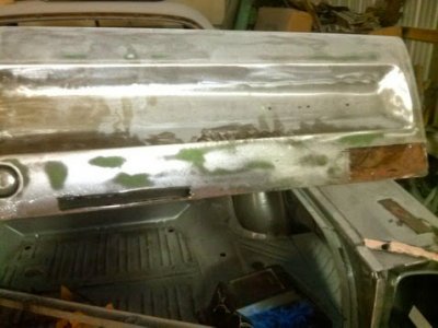

In that time the bodywork has been ongoing (I am not doing it myself as I have no experience and didn't think this was the car to start gaining it), and is nearing ready for primer. In between, however there was a ton of sheetmetal replaced:
Driver and passenger side floor pans
rear footwells
rear seat pan (back)
trunk floors
back half (south of shock bracket) frame rails
Full quarters, taillight extensions, lower panel
repair to existing trunk

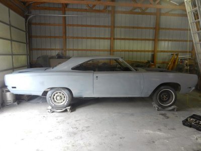

some photos of the progress:

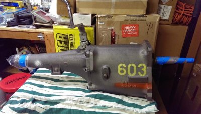

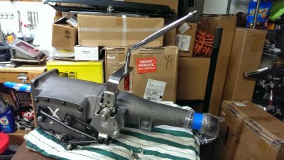

in the meantime the 4 speed was rebuilt as well as the hurst shifter, including a rechromed stick. Gonna drop a whilte Hurst ball on it to go old school (never had the original woodgrain knob anyway)

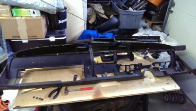

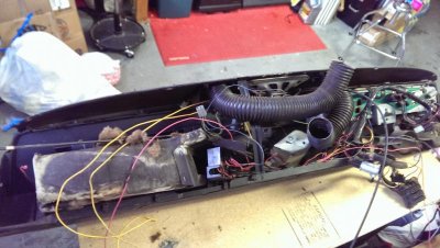

took the dash completely apart this weekend, and will blast the frame and repaint. A buddy local to me working on a similar bird restored his dash recently so I will be able to use as a reference and get pointers on the resto.

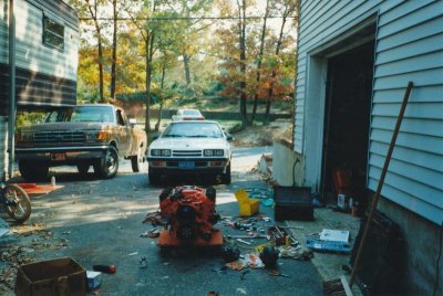

just for $hits and giggles, here are some photos of the car in during its previous refresh in '89 - me and my dad working on it
