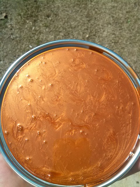

After seeing a68postcars thread on the BEAUTIFUL F8 car he was doing I almost went back to the original color, but stood by my decision to go Bronze Fire Poly

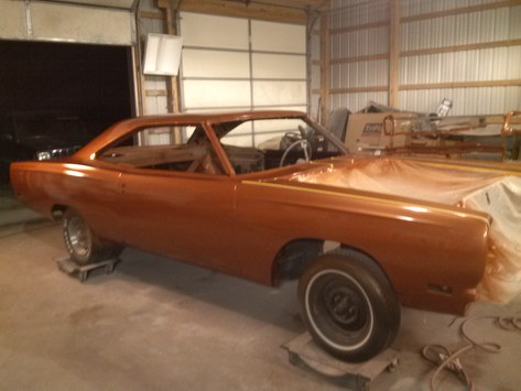

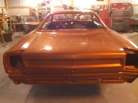

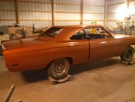

Paint laid earlier this week - hoping to get to see the car over the weekend.

the only pics I have are kinda small, sent from a cell phone...
Dude! I am diggin that color. Looks great, keep up the good work.

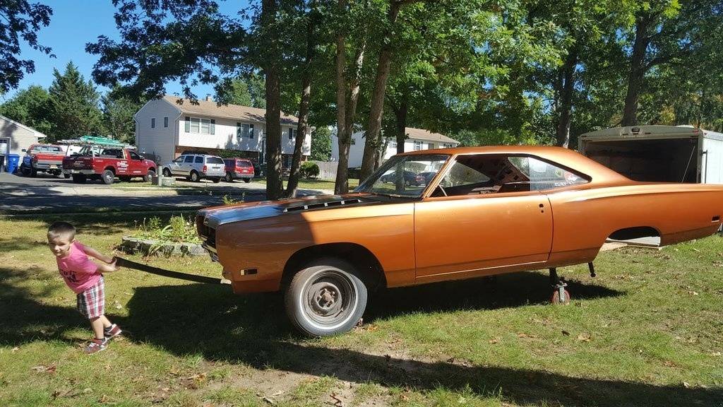

The car came back home last year - and since I have a one car garage / workshop it wasnt fitting in there. So...I bought a used enclosed trailer to put it in.
But before it went it I did remove the rear end and put it on the dollies (from US Car Tool). In hindsight I should have bought those while the car was at the body shop and removed the front and rear suspensions to begin work on those, but you know the saying about hindsight.
The car was then put in the trailer (pic is of my 5 year old "helping") for the winter - I hope to pull it out from hibernation in June and take the front end out to begin work.

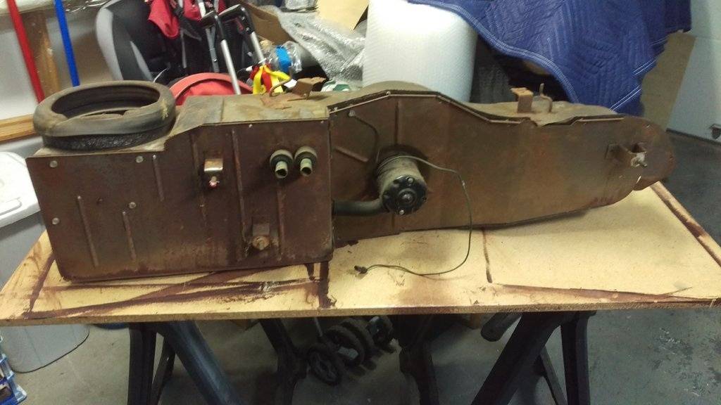

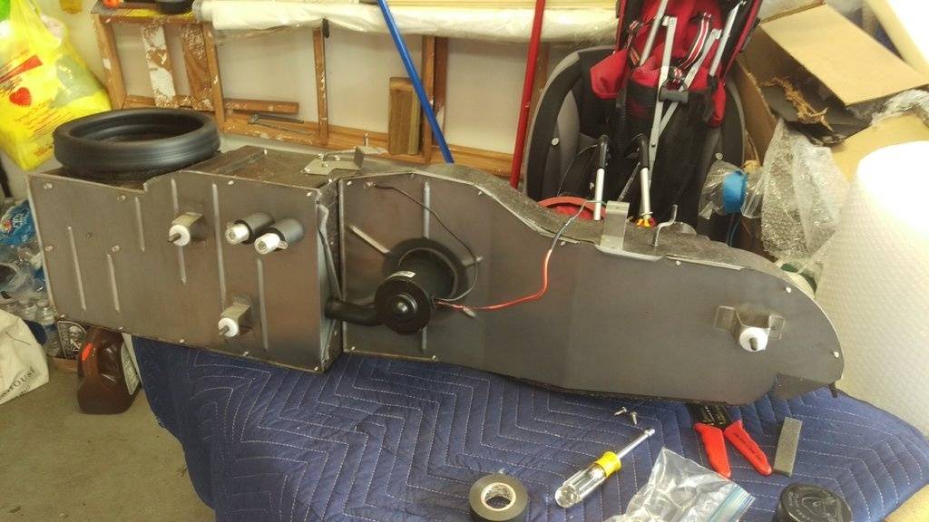

After clearing out some space in the garage I have been able to work on some of the systems - recently completed the resto on the heater box. Unfortunately the new blower motor from NAPA was not a direct fit, and required making new slots in the mounting plate in order to get the vent tube to connect to the box correctly.
Before:
After:

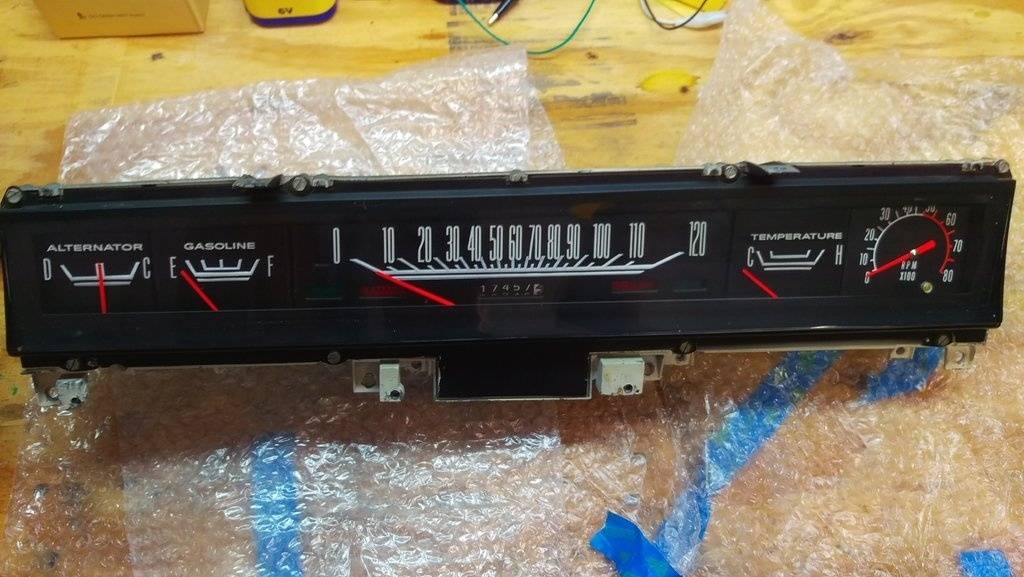

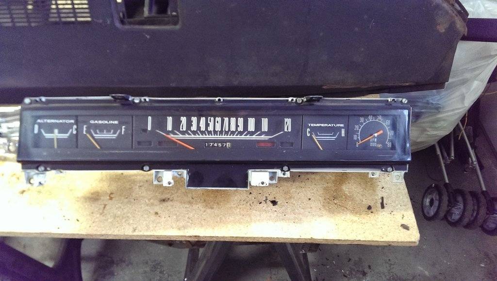

last year I had resto'd much of the instrument cluster - used Mr. heater box for the vinyl templates to redo all the gauges and odometer numbering, except for the tach, which I sent out to performance car graphics (I think?)
Before:
after:

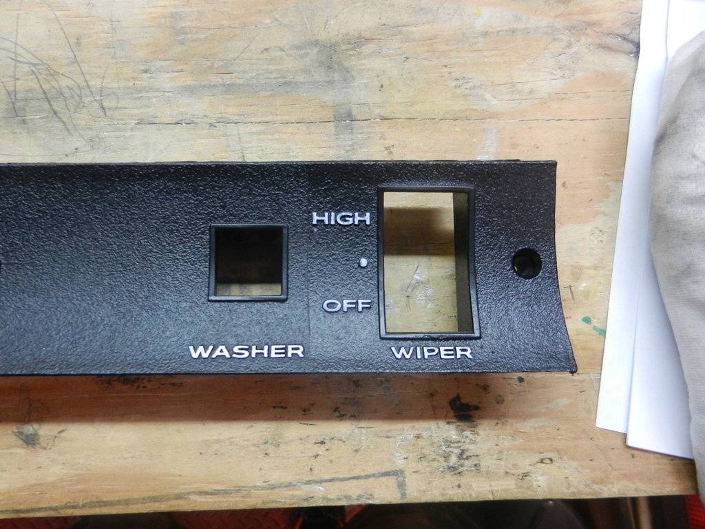

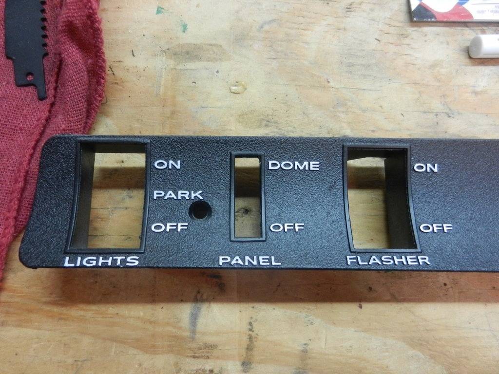

Redid the switch panel as well, using SEM Trim Black, and paint pens for the lettering (dont have a before shot, but I swapped out panels with a friend since mine had a defrost switch and I wasnt planning on putting that in, plus that panel was tweaked a bit).
