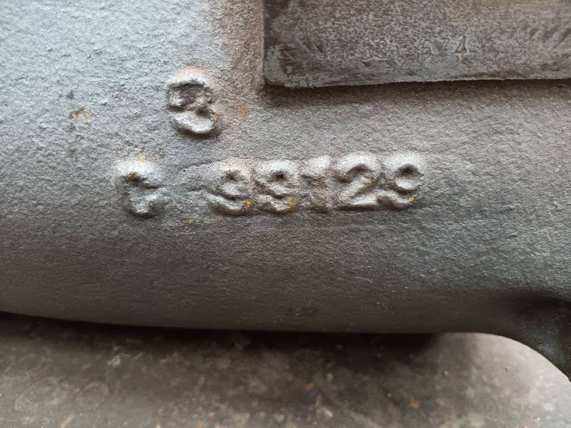

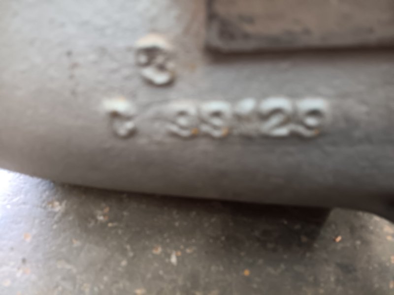

I may have located an A833 Transmission. This one has over drive so possibly built between 1970 - 1976.
Main Case Casting Numbers C-99129
Tail housing C-99539
• Cast Iron Main Case & Tail Piece
• 23 Spline w 307 Bearing
• from 1970 to 1976; Tail housing used in B and E body cars.
• Seller wants $350.
I think it's a win. What do you think?

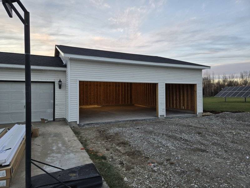

I have a very good job in a technical field that pays well. In 2024, I built this garage addition with the intent of restoring Mopar B-body cars in it.
I have the means and will to restore these Rolling works of engineering art! This is something I've been waiting for over 30 years.
