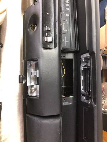

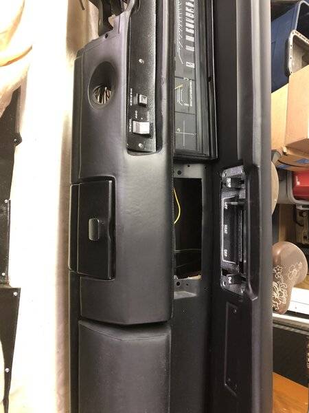

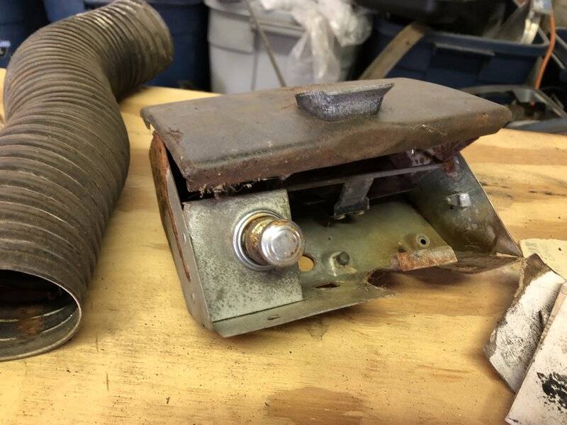

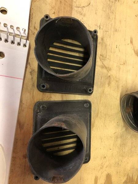

Another step in the process. Completed the ashtray and installed the vents. What a rusty mess!

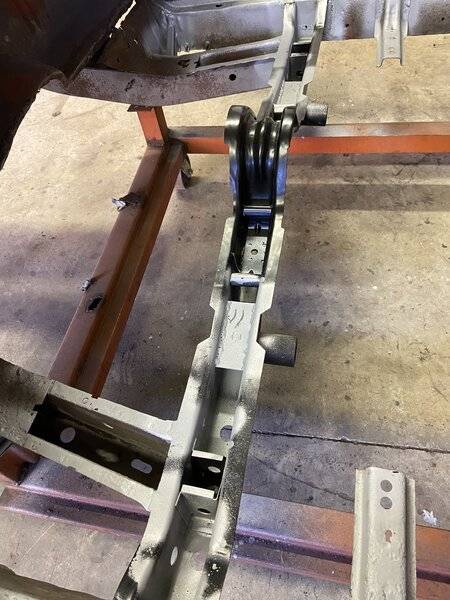

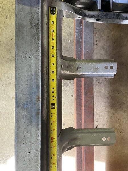

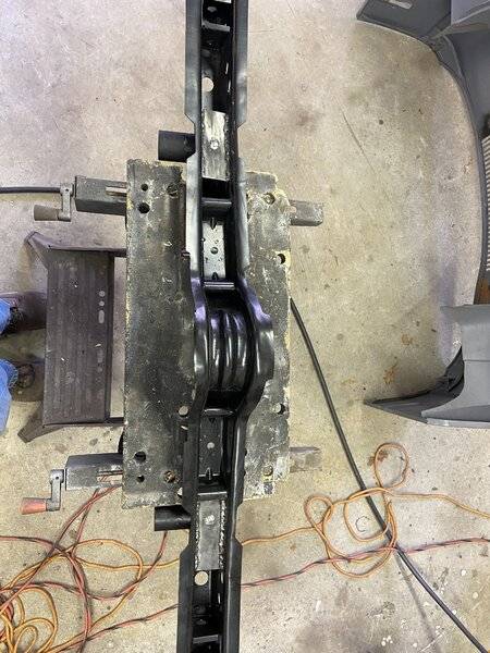

Now I am back on the rust repair. Installing a new crossmember and rear valance with rear frame-rails. Could be a while.

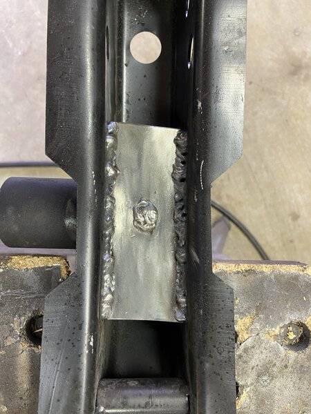

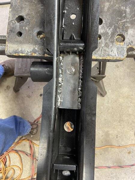

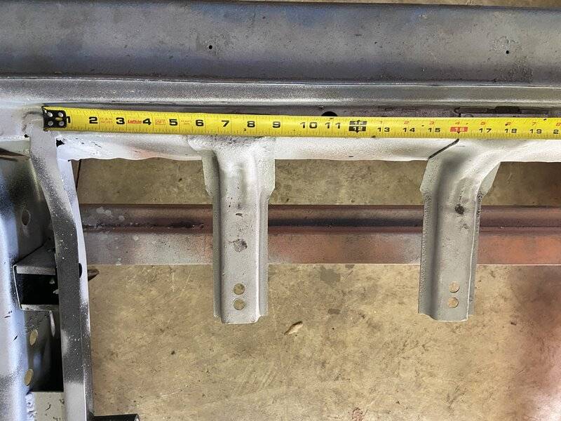

Installed this weekend and finally took a pic. (silver is weld-through primer)
Now on to the roof replacement or maybe the rear valance and rails... A lot to go.
RGAZ
I think you are doing a great job. love watching the progress!

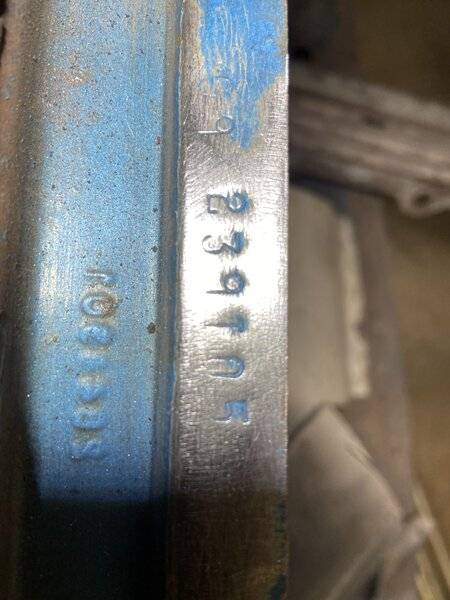

Did some number matching checks. Trunk gutter is a match.

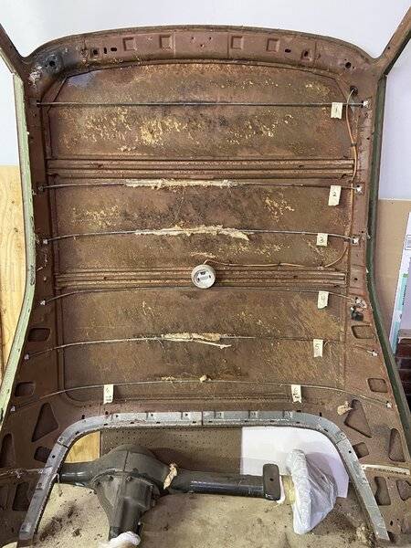

Now I will be removing the rear qtrs so I can prep for roof swap. Pic of my donor roof with the headliner bars marked:
Now I get to weld in support braces and measure measure measure, then template and measure again, then cut and weld. LOL

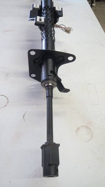

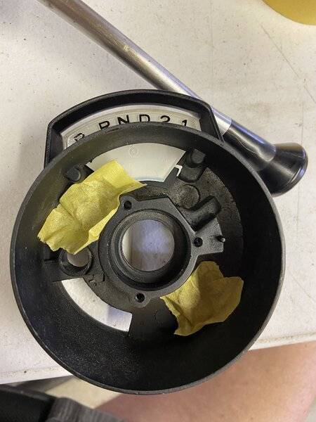

Money is tight so on to a cheaper time intensive project. Rebuild of the steering column. Step one, clean and paint parts...

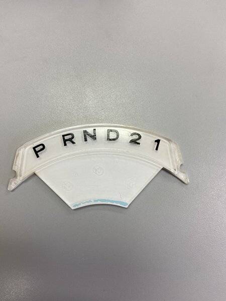

Next, spend multiple weeks looking for someone to do the vinyl for my PRND21 letters...
Discover a neat trick to make the square bolt assembly much easier. Just make the nuts the most loose and tape them down...
Next I will show the final assembly. Just waiting on my bushings and light bulb to show up....
Had to reset my bolt's twice so far. Those thing's are a real pain. LOL. Good job on the column so far. :thumbsup:

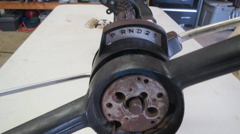

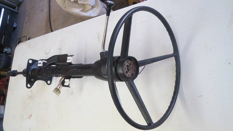

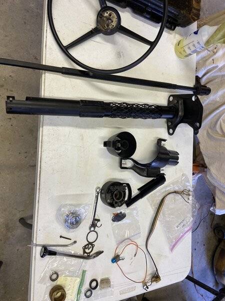

Mostly finished the column. I need a new steering wheel nut and the horn switch is shot.
RGAZ
Classic sells the horn switch. Look's good for what you have done. Also they sell the wire with the little wheel on it.
Thanks,
I was able to clean up and fix the little wheel so its working now. Looks like it was sliding in the past.
