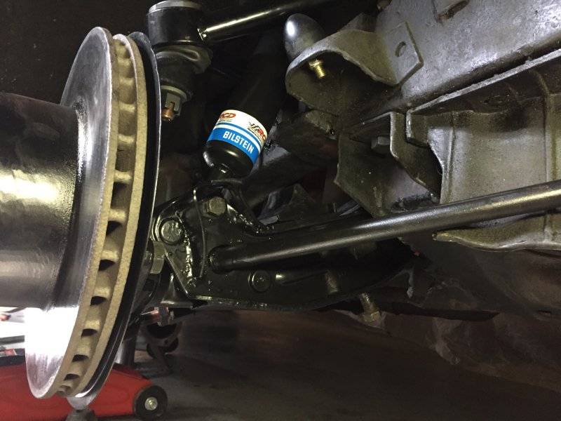

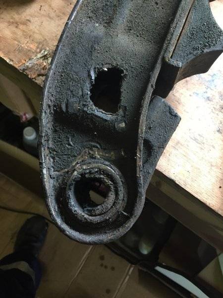

Hello all! Happy Sunday! Wanted to update everyone.
Lower control arm bushing were blown out. Replaced those and discovered lower control arm (passenger side) was cracked in half. Scoured the internet for LCA with sway bar brackets. They didn't exist. I ordered the brackets separately and had them welded on. NOW the car runs and drives the way it is supposed to! I brought the car home Friday night, spent all day Saturday putting new carpet and buttoning up some last minute details and get ready to drive the car and realize I have no brake lights. I spent hours under the car trying to track down the wire that connects to the brake light switch under the dash. I need to know WHAT color wire I'm looking for as I have already went through the wiring diagrams and can't find a definitive answer. Picture attached and once I figured out this brake light situation I should be GOOD to enjoy my first Sunday cruise! Thanks in advance.

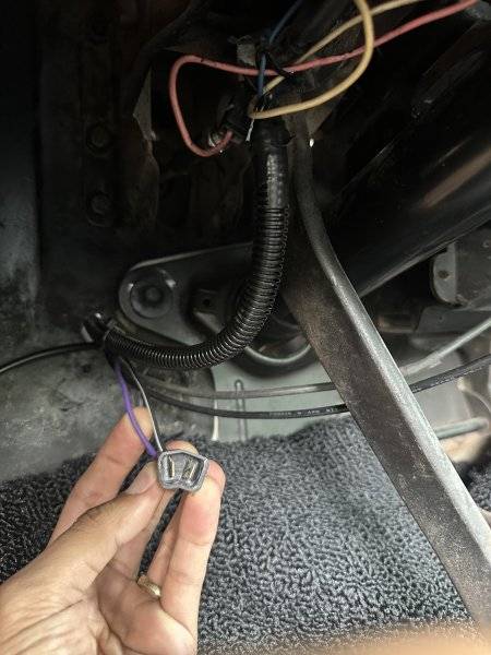

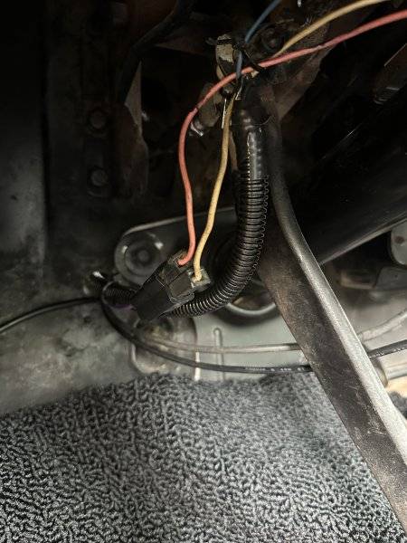

Both of those wires are plugged into a port going through my firewall. My buddy says those have something to do with the neutral safety switch which leaves NO loose wires or anything in my harness that would be long enough to connect to the brake light switch. I'm soooo confused because my brakes were already working a few weeks back when I started this thread lol.
Your buddy is wrong, unplug them and connect them to the brake light switch...
The plug that goes to the firewall plug would be a single molded shell with two connections not two separate plugs...
Thanks! Gonna go try that! In the meantime, what should be plugged into the firewall plug where these are currently connected?
That's a good question... I don't have a 69 Roadrunner, I have a 68 Coronet, it doesn't have that plug, What are the wire colors?
one purple, one black/white. Sort of a V-shaped connection.
Side note: My brake lights work now! Just need to figure out what this connection is lol
Was this a 68 car ? I was thinking 69... The color codes point to back up light circuit... And a 68 has the switch on the shifter, the moved to the trans in 69..
