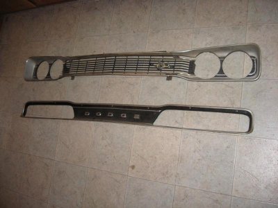

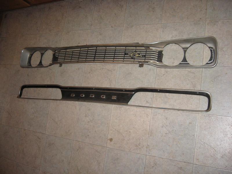

IMG_0610.jpgHi guys, need some help with these pieces. is the silver part suppose to be painted or is it polished? and if it's paint, what color do I need to get. and is the black part satin black or? Any help would greatly be appreciated.
polish it up, and leave it kind of dulled silver. You can spot the repo ones a mile away,they are almost silver chrome looking which is not correct.
Mike
The silver paint area go with argent. Tailpanel is correct for 'Bee. If need to repaint use a satin finish black. Either way it's your car.
