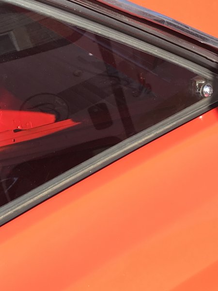

How do u adjust the 1/4 windows to seL against the 1-4 panel? My coronet has a 1/4” gap on the bottom where it should be sealed up tight against the 1/4
How do u adjust it on both sides?
Is it upside down and on the wrong side ???

no not upside down. And they are on the correct sides. Justy has a large gap between the lower window seal and the quarter.
I realize they were not designed to be 100% water tight, but a quarter inch gap is way too much to expect it to keep pine nedles and other things out of the bottom of the quarter/rockers

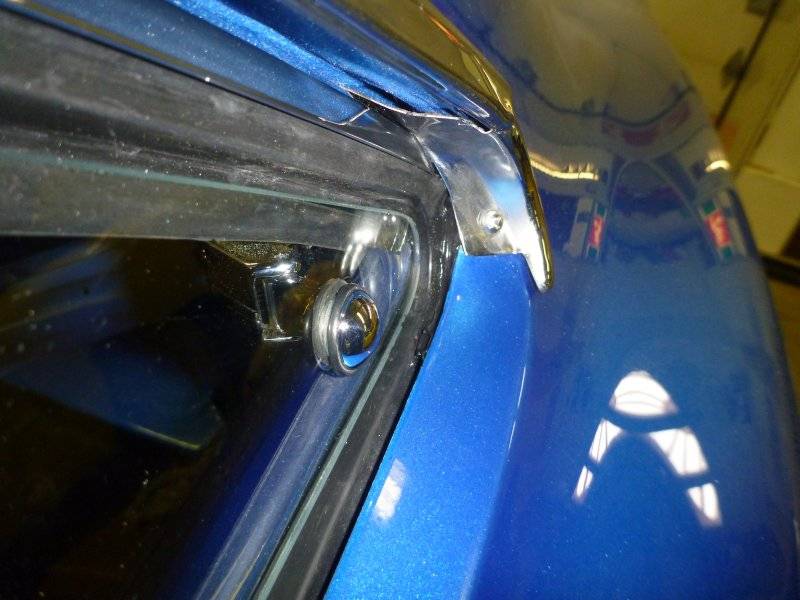

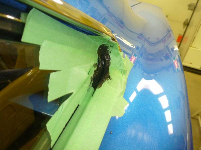

^^ weather strip it (or some gap filler foam), tape it off (both quarter and rubber seal) and then run a smoothed out bead of Black gasket maker down the gap and peel the tape. I had to fill the back corners on my Bee...
