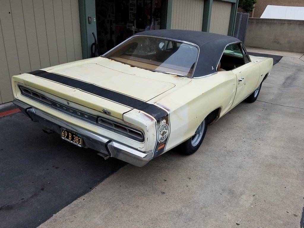

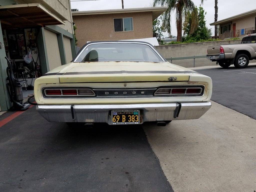

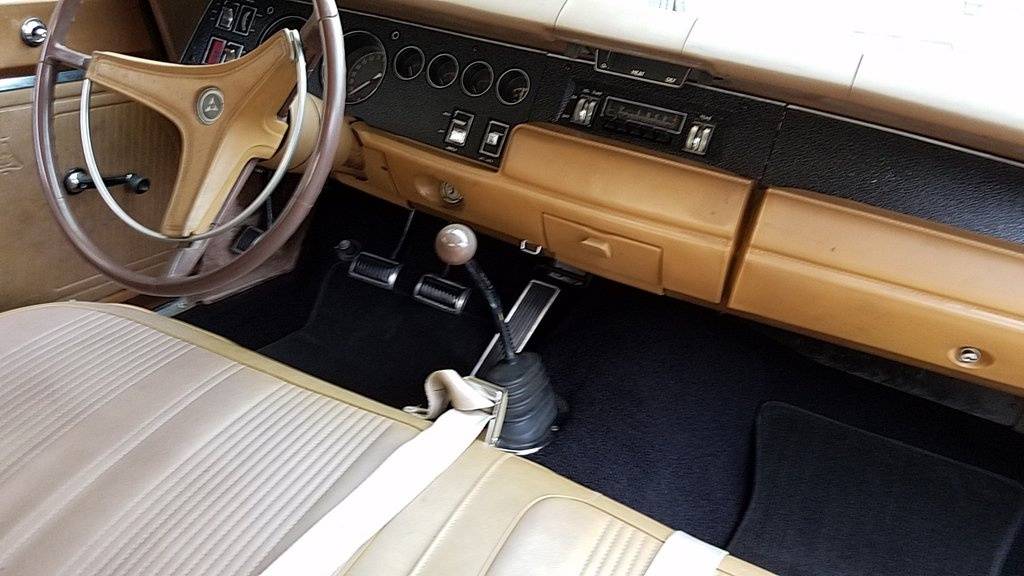

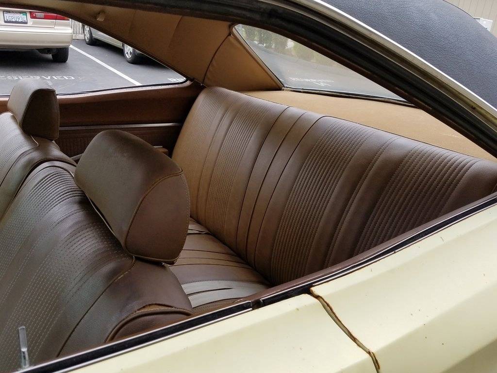

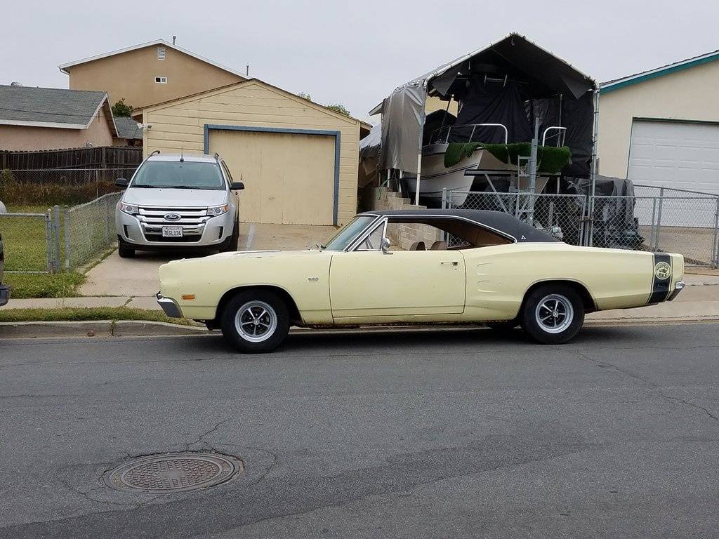

I would love to see more pics of your car. Looks like an original car.
Yeah it's pretty original. Perfect floors but some rust under rear window, trunk edges and right rear quarter shows a repair from long ago. 87K original miles.

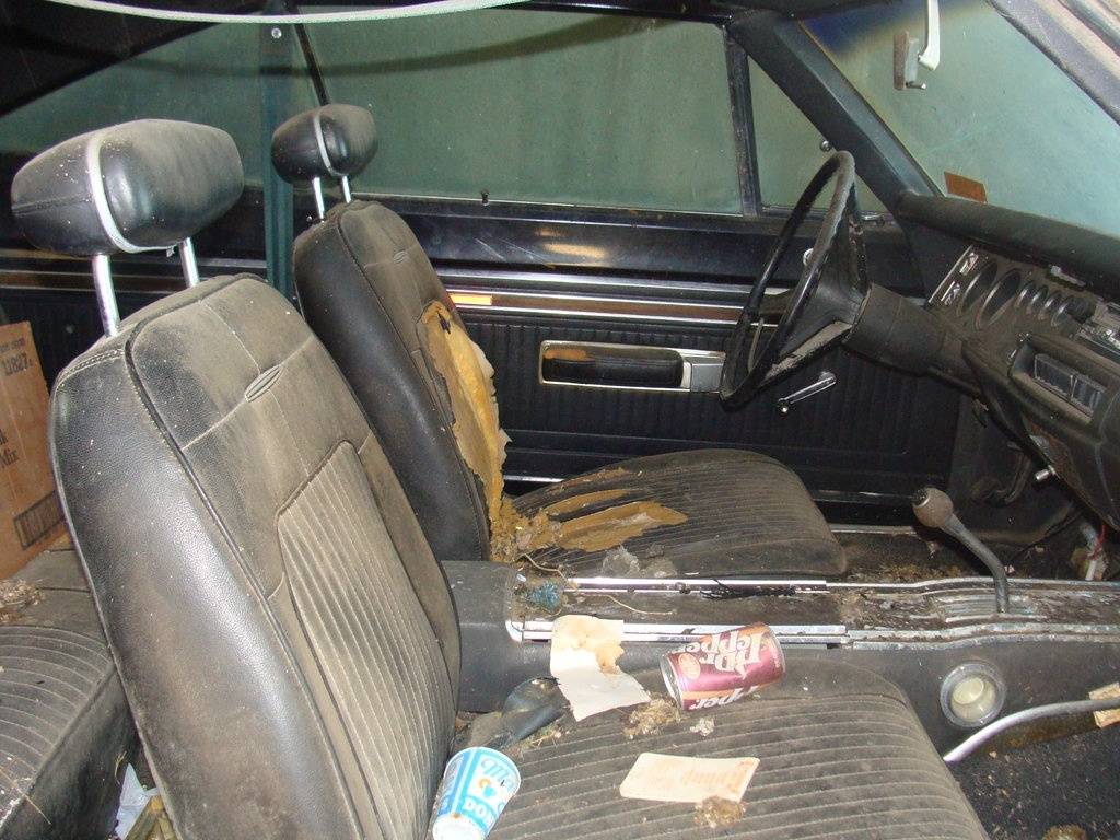

Mine has a little rust around the rear window as well and a little in the very back of the right rear quarter. Floors are nice, but a couple very small holes in the trunk floor from the rats and previous owner leaving stuff in there long term. The rats ate everything in mine. Your car is straighter than mine. I got it from the original owner's son (the white haired man in the picture). It sat in barn for 26 years. Mine has 25,000 original miles showing on it (22,000 when I got it) and according to the original owners son it is correct, he said she didn't drive it much and the mileage is correct. I didn't really believe it until I took the whole car apart and everything looked new and was original. Most items showed little or no wear. It was ordered by a female so she got several options on it. Wish she would have ordered a 4-speed though. Oh well.
