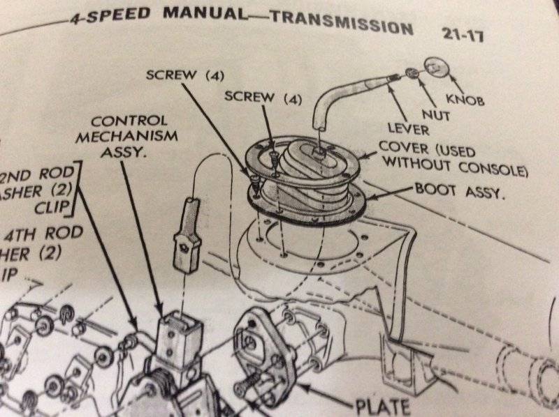

I guess when in doubt look at FSM dummy. Boot should have plain steel ring and attached with four screws then add chrome trim ring on top with another four screws
