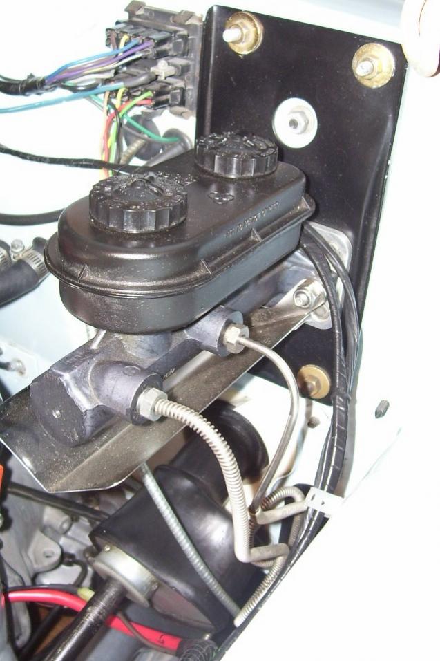

i use a 1.031 bore master cylinder. tried a .93" bore and wasn't entirely satisfied. stick with something around 1".
one of these in 1.031 bore.
