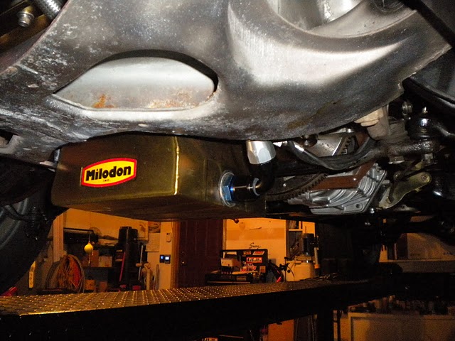

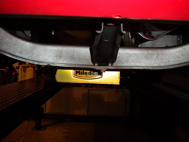

On my 62 Savoy I only needed to cut the passenger side lip on the K frame for clearance. here's some pics for reference. I can measure it but I'm not home at the moment.
