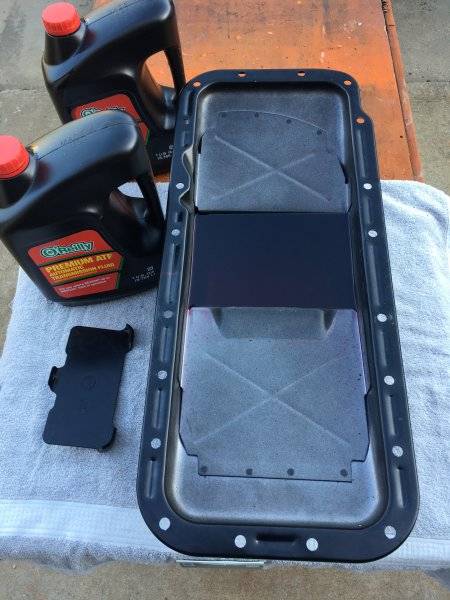

when i welded in a 2.5" lowering plate in my reproduction max wedge oil pan it now holds 8 qts right at the bottom of the splash shields.
after installing i put 8 qts in it, Marked the dip stick, actually at 6, 7, then 8qts, Only then did i spin the pump to prime the system. now i always now how much is in the pan.
