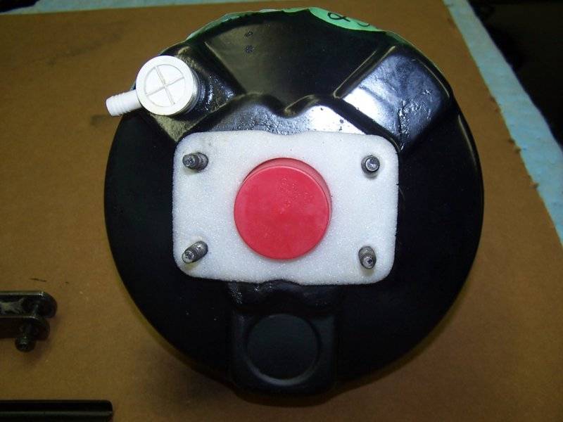

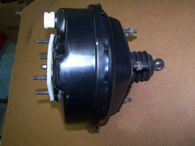

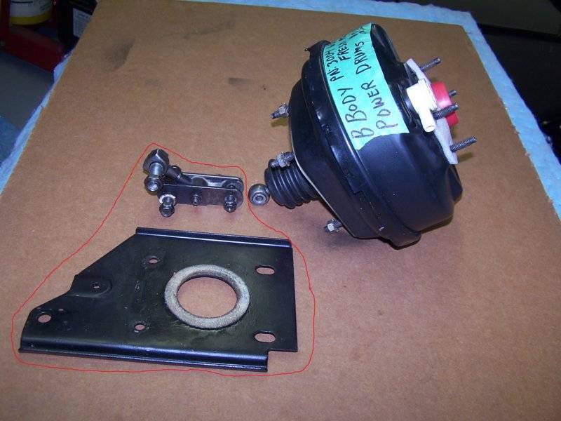

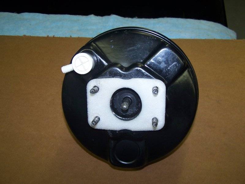

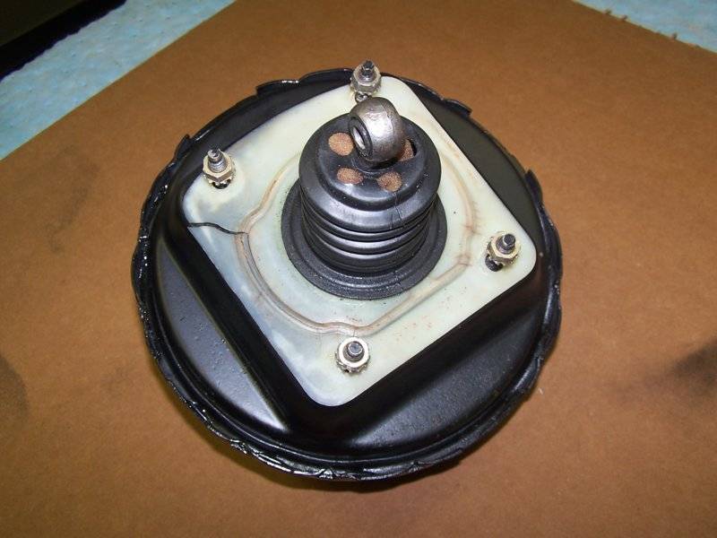

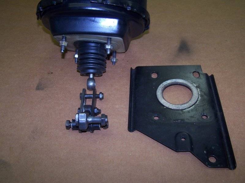

I have a booster that should be correct for your car. It came from my 68 Charger with drum brakes. I had it rebuilt by Booster Dewey back in 2015 when I built my car. I upgraded to disc brakes and needed to upgrade to a dual diaphragm. I have everything you need except for a master cylinder. I have $300.00 in it. $250.00 plus shipping. PM me if interested
