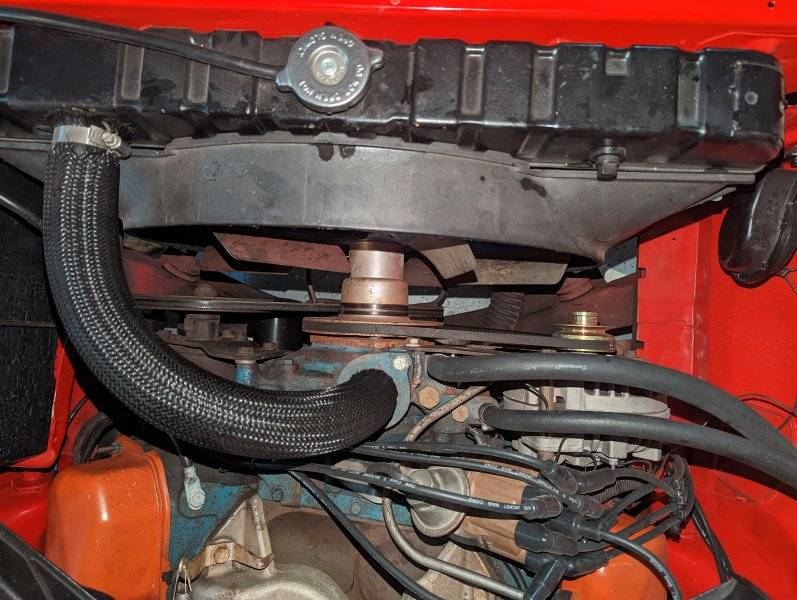

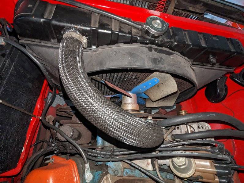

Standing outside my car, facing it, the my top hose (where connects to thermostat) is on the top right of the radiator and the water exits on the bottom left side of my radiator. I can add water from the top center.
Is that where your radiator opening are? With my quick internet searches, a lot of pictures on websites where to to order them have the either backwards from what I have or both ports on one same side. Just wanted to check if I have anything different.

Sounds like you have a 22" radiator, which makes sense if your car originally has a 318 (and no A/C). The heavy duty cooling radiators that are 26" wide have the top return hose on the left as you look in the engine compartment.
Your water pump housing must have the inlet on the passenger side as well which is an "odd ball" for a big block.
They did make 22" radiators for a big block with the opposite arrangement on the hose connections compare to what you've described.
But you would need to replace your water pump housing if you choose to get that style.

My top hose from the thermostat is on drivers side and the water pump connection is on my passenger side as shown in the pictures below. The top braided hose goes to the thermostate where at the very bottom you can see a corrigated hose which connects from the water hose to the engine block.
FYI my engine block is stamped Oct 1972.
Is this port arrangement standard for 70 Charger 440?'
