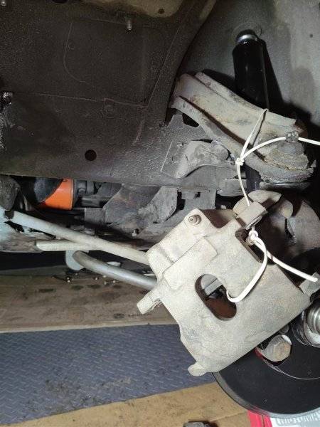

So I bought the Moog K7103 offset bushings to get more caster when my car is ready for an alignment. I will also need to remove my UCA's to install new UCA bump stops as mine look like squashed grapes. I was able to remove the old bumpers, but jacking up from the control arms, they don't lift up enough to install the new ones.
I've been doing some reading and found a lot of horror stories discussing installation issues with upper ball joints...control arms stripping out, new ones not threading in, needing to be welded in, etc. I want to keep my original UCA's if possible, as it seems the repops all have fitment issues.
What are your recommendations for safely replacing the upper ball joints? Any part numbers to suggest? I would prefer greaseable ones. I am pretty sure my Charger had the UCA BJ's replaced at least once before, many decades ago. They might actually still be okay, but how best to check the condition? Thanks guys.

The lowers look good. Just check for play? The uppers don't look bad either, I definitely scraped out a lot of old grease, which is a better sign than if they looked dry and crusty. The boots don't look great. One could hope they're still in decent condition but my experience this summer has been to expect the unexpected and I've had to replace more parts than I expected to. I'm sure we've all been there... :rolleyes:

With the upper ball joints, I don't know that I've ever had one get loose and wobbly. I've had them get stiff and hard to swivel. They may have not been worn out but it felt to me like the lube had hardened up and dried out. I may have been okay just replacing the grease boots and shooting new lube in but for most of my life, I've paid for alignments and wanted to be sure that any and all parts that were bad were replaced before spending the money and arranging the time to go to the alignment shop. Now that I'm doing my own alignments, that may change.
I made the mistake of trying to remove the ball joints with the UCAs in a vice. This was stupid because the act of UNscrewing them requires a lot of leverage. It is best to leave them IN the car and let the mass of the car body hold the UCAs in place while you use a long cheater bar on a 1/2" drive ratchet. Then you can remove the UCA to replace the bushings.
Unless you're SURE the UCA ball joints are bad, leave 'em. The load on these suspensions is on the LCA. The UCA is just a follower. For cosmetic purposes you can clean/paint the UCA, replace the boot & lube. Be more concerned with the LCA bushing.
