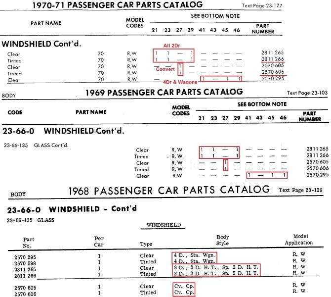

It shouldn't be that hard to find. The same glass fits all 1966-70 B body coupes. ALL Chargers, all Coronets and Belvedere/GTXs that are not wagons or 2 door post models, right?
Wagons are their own beasts, you have Coupes, Convertibles, 4 DRs, and then Wagons, (Mostly because Wagons were the same from 66-70)
Just go to your local car glass installer, should be no reason they can't get one. It's that or an AMD dealer for a repro.
Local glass shop. Find someone experienced. Part number for a 70 bbody 2 Dr coupe is DW715. Not sure if clear is a option thru the glass warehouses anymore. You will have to ask . I got green tint, blue shade from pilkington, 4/5 years ago.
Clarification: One windshield (tinted or clear) for All 2-Door *post/hard top/sports hardtop*. One windshield (tinted or clear) for convertibles. One windshield (tinted or clear, but note that tinted disappears from 69 and 70??) for 4-doors and wagons. Also note that all part numbers remain consistent throughout. FWIW
*Add edit
Clarification: One windshield (tinted or clear) for All 2-Doors. One windshield (tinted or clear) for convertibles. One windshield (tinted or clear, but note that tinted disappears from 69 and 70??) for 4-doors and wagons. Also note that all part numbers remain consistent throughout. FWIW
Thank you. I knew that the 4 door, wagon and convertibles were approximately 2" taller than the 2 door cars but I thought that the post roof cars also had a taller windshield. It is that way with the 67-69 A body cars.
