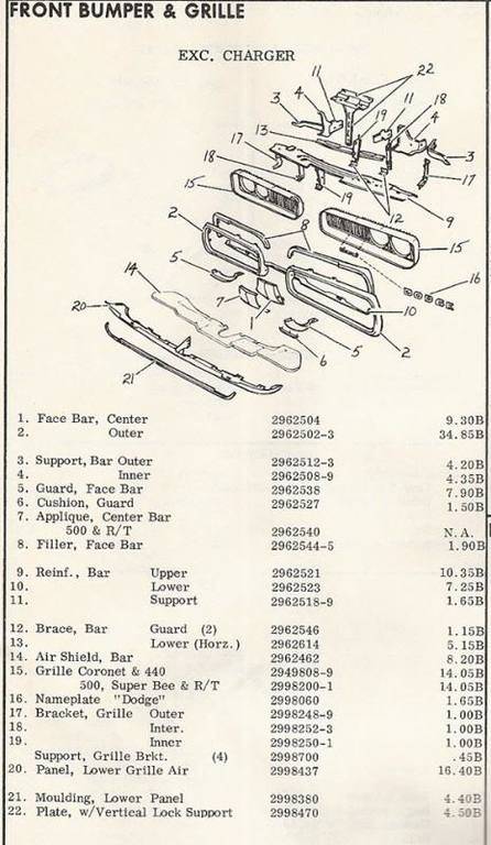

Parts book shows Dodge name plate only on the WL and WH models; none for the Super Bee, 500 or R/T.
The parts diagram from the original parts manual shows the dodge badge in the grill regardless of model ...and I have a real r/t convertible with the badge in the grill ....I am the third owner father was the second owner since 1973
Thanks. Can you post a picture of your parts book. By 'original' do you mean a first version 70 book or the revised 70/71 book? Mine is the revised one and I'd like to see if the first version was different.
Heres the diagram I have part number 16 is the dodge badge
That appears to have come from the collision parts book, not the parts manual. It will show all the parts that 'could' be there but not necessarily application. The parts book shows 2998060 goes on the WL and WH models. Unlike '69, I don't think there is a 1970 MY specific emblem for the Bee or R/T logo.
Again, what colors are the grilles that these Dodge emblems are showing up on SB,s 500's and R/Ts? Are the Grilles black or argent? Notice there are two separate grilles listed in the picture. The question comes up for these cars that have 'non standard' Dodge emblem applications.....were grilles removed from Coronet Deluxes and 440's to replace broken grilles in SBs and R/Ts? Did body shop repair guys add the emblem during a repair? Are there original pictures of the cars that show the emblem? Does anyone have original advertising pictures that show the Dodge grille emblem on a SB, 500 or R/T?
