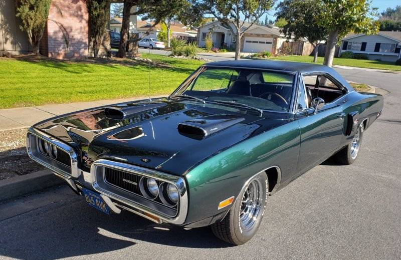

Magnum 500s, 15x7 and 15x8, RWL 225/70/15 and 275/60/15.
Did a LOT of rewiring and cosmetic stuff. Car is now at a trusted mechanic for 1-2 months for all the stuff I have no ability to do myself (exhaust, fixing various brake problems, some engine stuff, etc.) Once back I think I can finish all the remaining work by March.

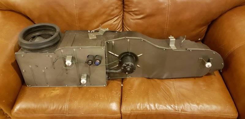

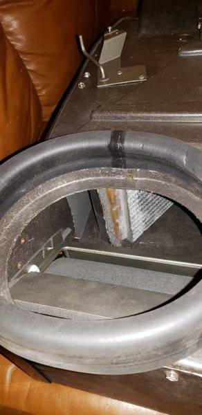

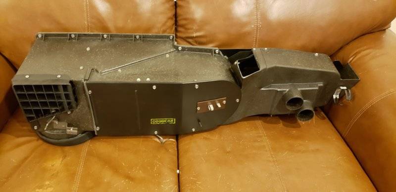

Although I decided not to do a blow-by-blow build thread I can't help but post pictures of my rebuilt heater box. Rich at http://heaterboxguy.com/ did a fantastic job. Will be a while before I get it installed (not looking forward to that job, getting it out from under the dash was annoying enough), but I'm sure it will work fine. They were even able to save the original fiberglass finish of the box.

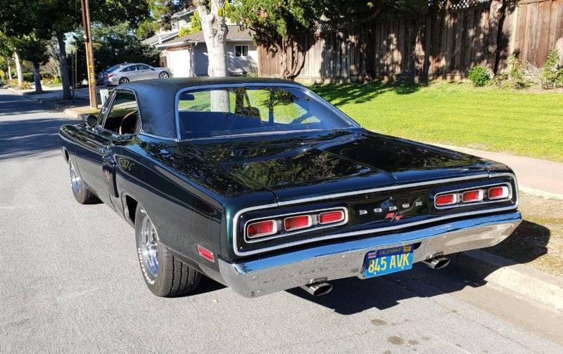

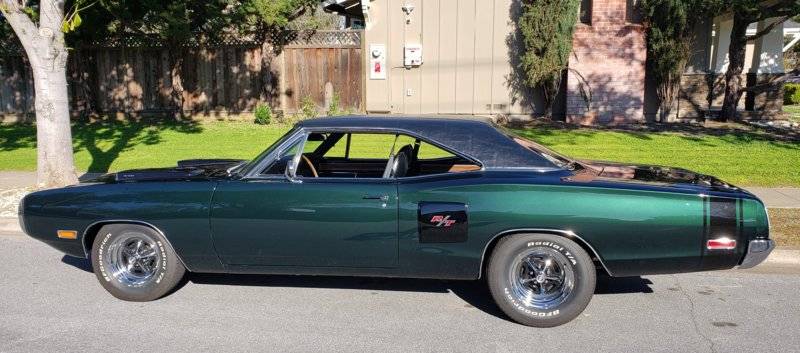

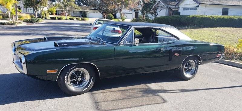

Got the new wheels, tires, valve covers and full new exhaust with cutouts installed. God, these Magnum 500s and fat RWL tires look so much better than the blingly early-2000s crap that was on there before. It looks like a REAL (if not factory-correct) Mopar finally, and the exterior is pretty much "done done" now. Sadly though the car wouldn't start after I drove it back from the performance shop; it just backfires immediately after cranking. Since I had them replace the dizzy this is suspect number one, but my troubleshooting skills were not enough in this area to make progress so I towed it back. Grr. Well, I'm still looking to be ahead of schedule, probably will be "done done done" end of January. New heater box is in and I was just about to drop in the cluster and trim pieces. I think the oil sender is bad and will need to replace that, but it should be easy. There may still be oil leaks to track down, which I will try to identify with some UV dye... that's the only big mystery left that could have a large downside. (I am OCD about fluid leaks -- I insist that none of my cars leak, no matter what the cost. I have had perfectly good engines rebuilt before just to eliminate leaks.)

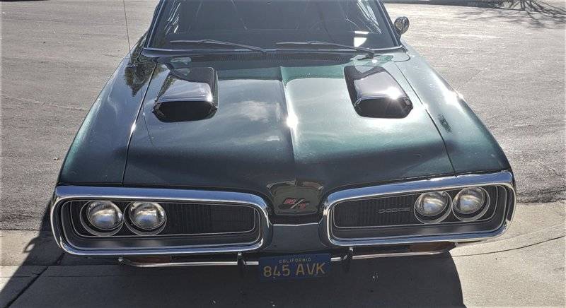

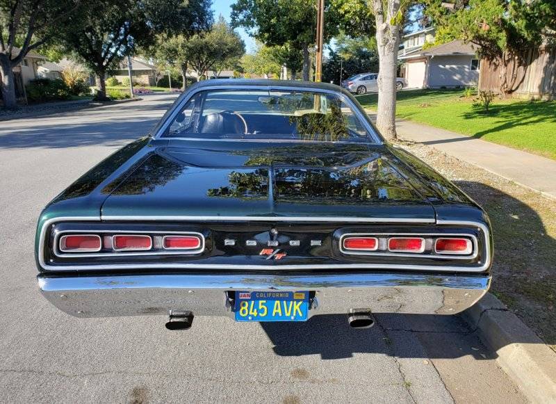

Oh, and I discovered the ORIGINAL 1970 California plates were hiding underneath the dealer plates! My plans for personalized plates are now canceled since these are basically priceless.
Much better. I wouldn't change a thing now. I even like the green. What happened to the old set of wheels? It didn't look bad with those on either.

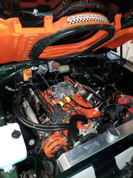

Aside from the leaks she drives great. Timing was way off when I got it back from the previous shop and the car was bogging horribly. Swapped the old hacked-up Edelbrock 1412 with a new 1812 and learned to use a timing gun and fixed all that. (Although as an amateur I'm sure it's far from being optimally tuned... that will come someday.) Worst case is this will spend three weeks in the engine shop but after that it's dunzo done and ready for spring.
Shop is confirming the oil pan gasket needs replacement, but thinks main rear seal is OK. They think this can be fixed without pulling the engine. They also say the valve cover gaskets are still leaking, which is unfortunate, since I had two previous shops claim they fixed those. Ugh. They are also going to look into the possible coolant leak around the back area of the driver's side exhaust headers... they knew immediately what I was talking about when I mentioned that some of these bolts go into the water jacket and are notorious for leaking. As I mentioned above this shop rebuilds muscle engines as their specialty and I can't think of a better place to do this work. (If anyone needs a personal rec in NorCal for an engine rebuild, PM me, they did my GTO 400ci flawlessly.)
Christ. I am calling it "done done" for now. Main issue causing the oil leaks was high crankcase pressure caused by having TWO PCV valves (one to vacuum and one to the air cleaner) instead of one valve (to vacuum) and a regular breather (to the air cleaner). Items like the funky oil pan gasket needed to be addressed and were, but due to the high pressure, oil would just force its way out of another place.

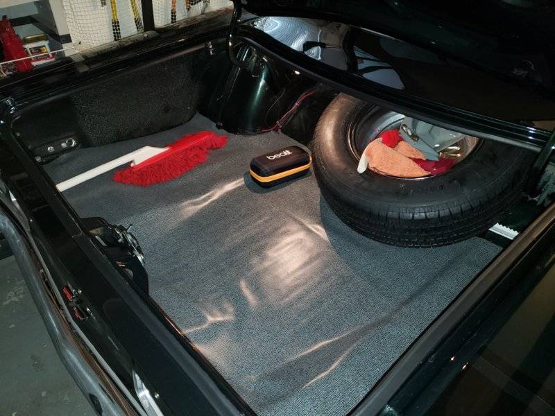

  • There is a trunk water leak. I think it's the weatherstripping, so I've ordered new stripping from Metro and will compare it to the existing stripping. If it's obviously "bigger" in such a way that it seems it will seal better, then I'll go ahead and install it, otherwise I'll just deal.

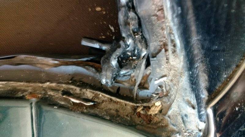

However, I just dropped the car off at the body shop to fix a leaky back window. After popping the window, they have found rust. I asked if metal needs to be replaced and they say they are still cleaning it and will know soon. I was not planning on having the car sit for three months for cutting, welding, a partial repaint, and maybe a new vinyl roof, but if that's what it takes... (Will any of us ever escape the ghosts of cheap-*** previous owners? Stupid idiots should have done this before the repaint and new roof they put on. This is a guaranteed rust area for ALL Mopars, even California cars that don't have a ******* speck of rust elsewhere.)
Body shop just told me the rust looked worse than it was... they claim they can fix and seal it without having to cut&weld. Everything I know about bodywork I learned by watching YouTube so it isn't immediately obvious to me how that's possible, especially considering that they told me it was leaking because of corrosion. But this shop has done me well numerous times in the past so I trust them. (I just hope that in another 50 years somebody else isn't cursing me out for being one of dem dere "cheap-***" previous owners lol.)
