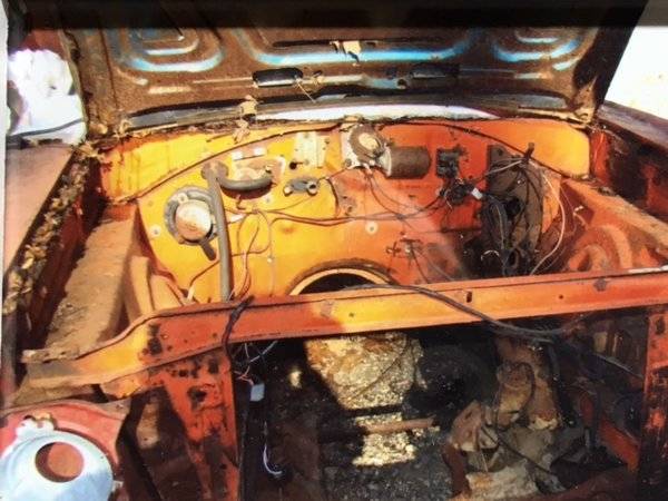

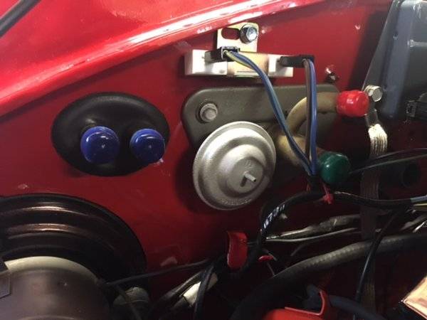

have above which is a factory air car with 4sp manual pistol -
trying to determine how many a/c made in 70??

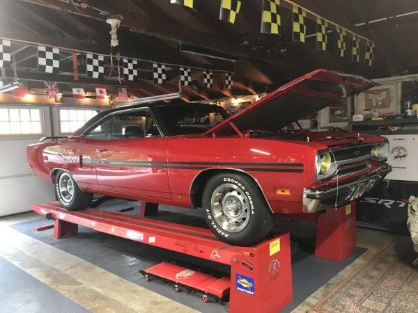

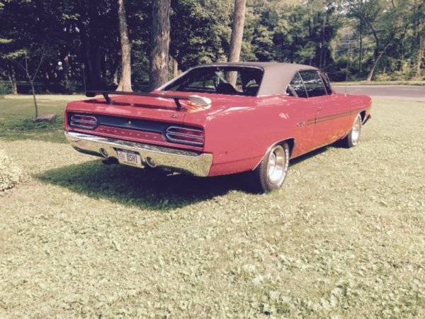

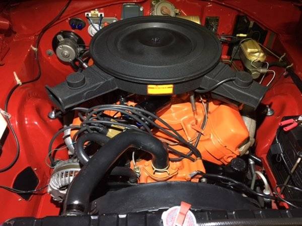

Good looking engine bay....any more pictures you want to share?
BTW I cannot help with the A/C question.....but I do have a B51 on my tag. :)
Beautiful Car!

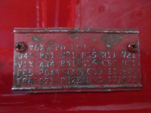

this shed any light - all i got w car - no build sheet
Yes.
VIN, SPD and VON look legit.
No inspection stamp in upper right hand corner, no punch through inspection stamp, no bend in upper left hand corner.
Info likely copied from original tag with A34 and D21 added.
Fender tags are the easiest documentation to fake. With no BS or window sticker to back up the tag.....well...
If the car did not have the N96 Fresh Air induction(and it appears from your pics it does not...), it would have been possible to get A/C, irregardless of whether it was a four speed or automatic transmission.

The first thing that cought my eye was the character stampings look to be somewhat flattened.
Did StL cars get an insp punch?
My 73 def does not have a bent corner.
that tag looks pretty old to me, does anyone think repopping a phony tag was worth the hassle 30 or so years ago? I bought my GTX, running and driving, for 900 bucks back then
