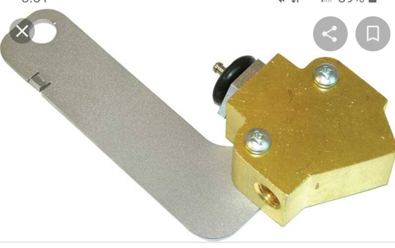

I'm trying to bleed the brakes on my 70 GTX, factory power disc brake car. All the lines are new. I replaced the hold off valve that splits the front brakes with a new one made by inline tube. When I step on the brakes fluid sprays out the nipple on the bottom. That nipple doesn't seem to move in or out... any advice will be greatly appreciated!
I would see where it is leaking it might just be a gasket on there that is missing.
Send the **** back and put the old one back on. After seeing all these posts I'm sure glad I refurbished my master and used my old valves.
Inline Tube valves seem to be the worst, lots of posts about valves that either don't work or leak....
Fine Line sells the valves too but they claim to disassemble them & check the fit/function of every valve here in the US & hand lap the spool if needed...
Personally I have original valves & will be buying the kits from Musclecarresearch.com
