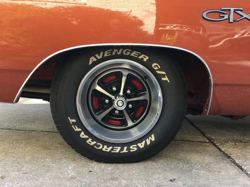

A picture would be helpful as you did above....
My tires are P205/70R14, which means my tires are 'taller' than Bill's, yet my rear is lower than his.
From looking at Bill's picture, his fender/quarter panel seems to be higher up on the tire than mine. My fender/quarter panel seems to cover the top 1/4 of the tire. Bill's seems to be about even with the top of the tire?
I'll get you a picture tomorrow, the car is not at the location where I am.

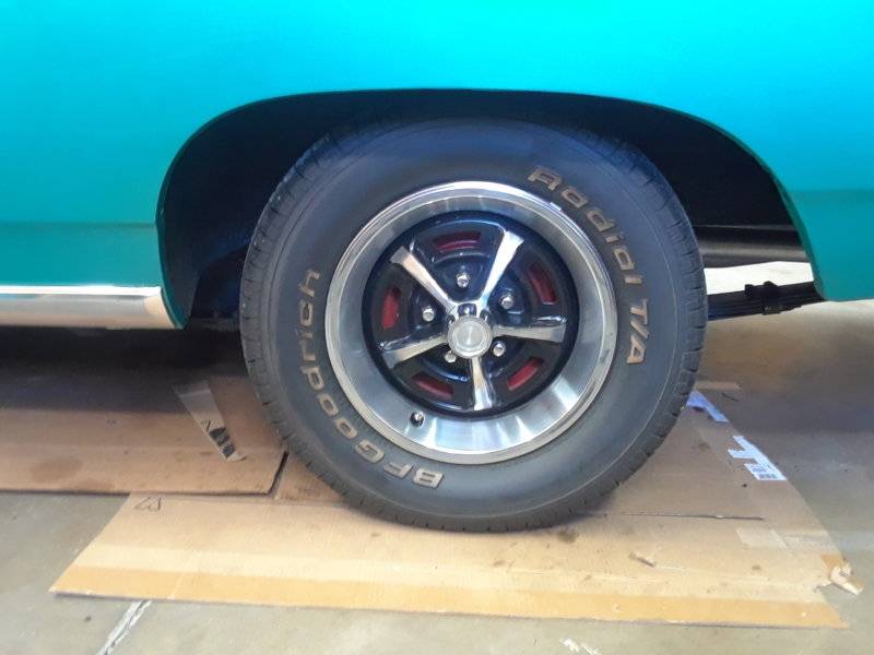

I've attached some photos, seems that my car is lower than Bill's. I suspect my car is too low and Bill's may be a little high?

You probably are a little low.
