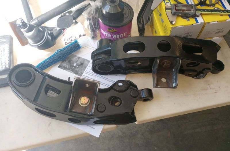

I've recently rebuilt my whole front end of my 70 B-body and with parts from P-S-T and Firm Feel. I found that my LCA's were a little sloppy so I cut them apart, tightened them up and welded reinforcement plates which I got from Firm Feel, but you can get them from a lot of places. It's easy to do if you have a welder or know a welder. Or Firm Feel can do them for you.
So if you still have the LCA's off the car it's worth looking into.
Good luck with your project
PS. Attached is a photo of mine with sway bar tabs mocked up.

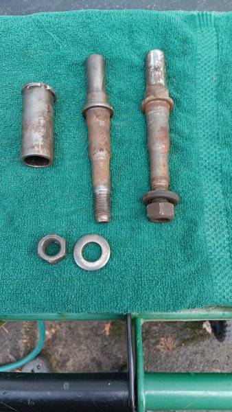

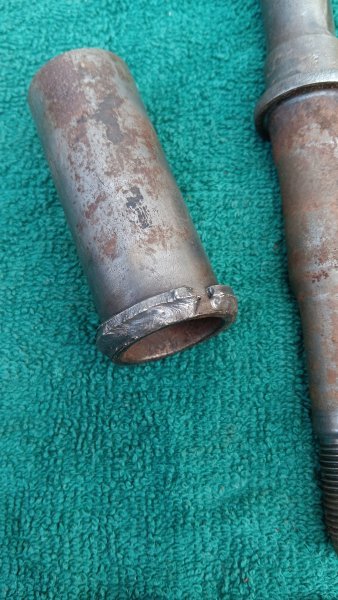

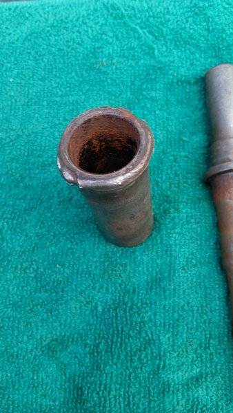

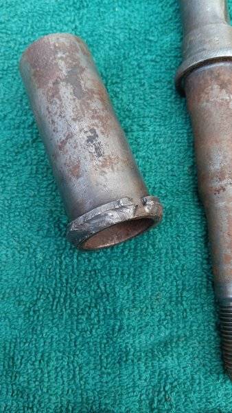

Update: I removed both LCA's and found the bushings in the worst condition possible. The driver side didn't have a rubber bushing left, it was just the metal sleeve over the pivot pin. To make things worse, the pivot tube had broken free from the K frame and it fell out when I removed the LCA. (see pictures). I was able to install the new pivot shaft and line up and re-weld the tube onto the K frame. It worked out good. I ended up buying a 12 ton press from HF to install the metal cups, polyurethane bushings and pivot shafts. I saw a guy on YouTube able to use a hard plastic hammer to install his bushings and pivot pins, that wasn't even close to being an option for me, I had to use the press on everything. Anyways, got it all together and it fixed my alignment issues, the front-end geometry is now correct, and the drivability is excellent. I drove down the road over the manhole cover again and the car didn't even flinch. I still have to fine tune the front-end alignment, but I'm very happy. One other thing: I decided not to use the lock nuts on the pivot shafts. I opted for grade 8 nuts and with a lock-washer. It's so much easier torquing those down without the shaft spinning and breaking out the pipe wrench (IYKYK). Thank you all for your input! I really enjoy this site.
