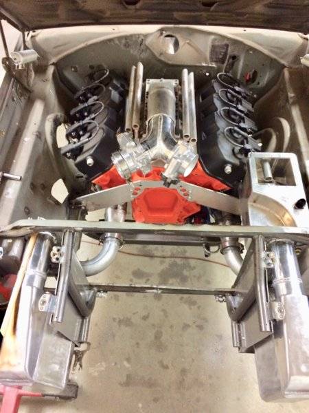

Throttle body mockup....and now you can see why the nose is removable and the center area is open. This allows me to stand in between the intercoolers so I can reach everything in the engine bay without having to lean over the nose or fenders.

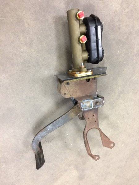

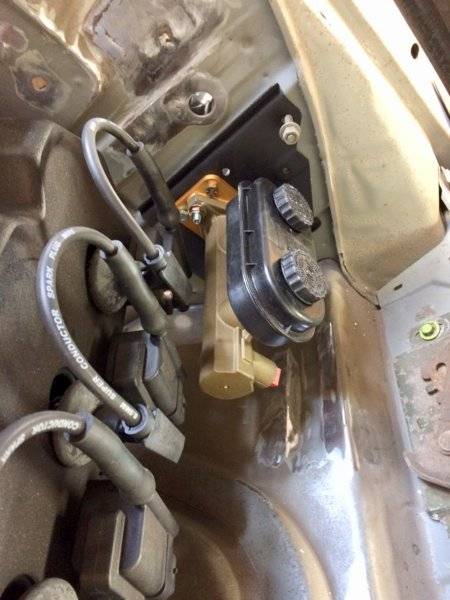

So... the wonderful thing about Engineering on the fly is that you get to re-engineer so many other things....lol. Adding the coils to the valve covers led to the need to move the master cylinder up 1.75” and moving the master cylinder up that far meant raising the brake lever pivot up as well so as not to bind the brake rod. Raising the pivot will also lead to extending the brake pedal 1.75” to get it back to where it was. The only plus is more leverage at the pedal..... (facepalm....)
That's why I try not to get anything to final till the end. There's always something that comes up you didn't see coming! Great work BTW.
Yeah I know.... lol. The plan is to finish the car before doing any final finishes. I already found some brackets that meed changed on the already powdercoated rear axle housing!
