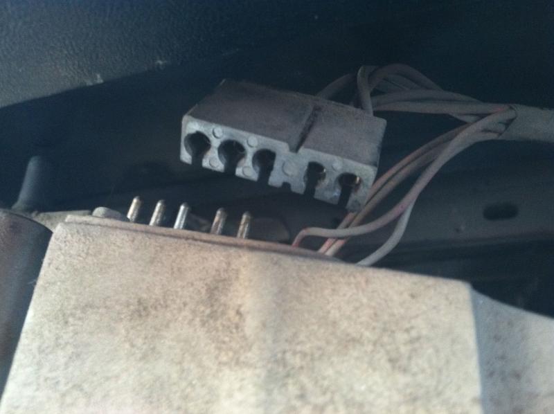

Can someone tell me the correct order the main cluster harness is plugged into the back of the cluster. The connector next to the speedo (5 pins). The reason Iam not sure if which color should be nearest the speedo as you can plug this in either way Thanx max
5 Pin Rallye Dash Connector
Unfortunately the colors are hard to see in this older (pre-restoration) photo of my dash (1970 Roadrunner - Rally Gauge), but you can see that the pins are divided (just barely) into a group of 3 nearest the speedo and 2 further away. You can also see the notch in the TOP of the connector when it is positioned properly. This pic is taken sitting in the front seat looking over the half-removed dash panel - toward the front of the car. Hope this helps.
