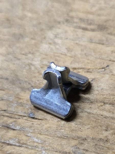

So I had the same issue. What I discovered is put the clips in the hole and then squeeze the 2 tabs that face you with a painful pliers to expand them
Please elaborate on this - I do not get what your talking about..
So here’s a couple of examples, the 1st one is a new clip unexpanded. The 2nd one is after it has been expanded. Hope this helps
Ok - Thats a possibility ...Ill give it a shot - see if it expands enough. Thanks!
