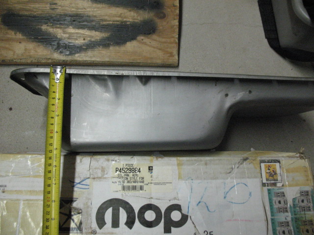

Scott,I just measured the MP Hemi pan@ 5 deepx12" across the sump.I had similar problems trying to fit the pan and pick-up due to the 1/2" tap in the block is at a slightly different angle making the pick-up sit lower in the pan. I ended up with the deep Moroso pan on my Super Bee,I haven,t had any bottoming problems due to the Edelbrock AIS shocks not allowing excessive suspension travel over bumps and dips in the road.

Thanks BeeZee....but how did you measure the sump depth of the P4529884 pan? Is it off the car? Don't mean to doubt you, but Summit lists the P4529884 pan as having a 6-1/2" deep sump and if it IS only 5" deep then why is my stock '70 Hemi pickup tube so long?

Brand new pan ootb
Thanks BeeZee--- that means it must be the pick up tube is 1" too long & my Milodon pan is just fine. Why the heck is my pickup so long???? It sure "looks" right hmmmm

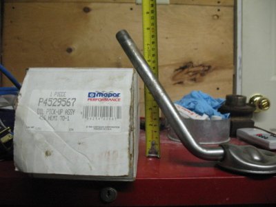

Scott,Here,s a shot of the pick-up that MP sells to work with the 70-71 oil pan.I also compared it with the 3/8 pick-up for the RB centre sump,the 3/8 pick-up is close to an inch shorter.

WOW! Now I am really confused..... I "thought" I might have a 68-69 Hemi pickup but I just measured mine & it looks like the same pickup! I've got a Milodon pan, but the sump measured 5" deep just like yours and sure looks the same.
What's the chance a stock Hemi block is different where the oil pickup screws in? The only other idea I have is that the pickup is cross-threaded or not all the way screwed in. I have about 3-4 threads still showing. ?????
