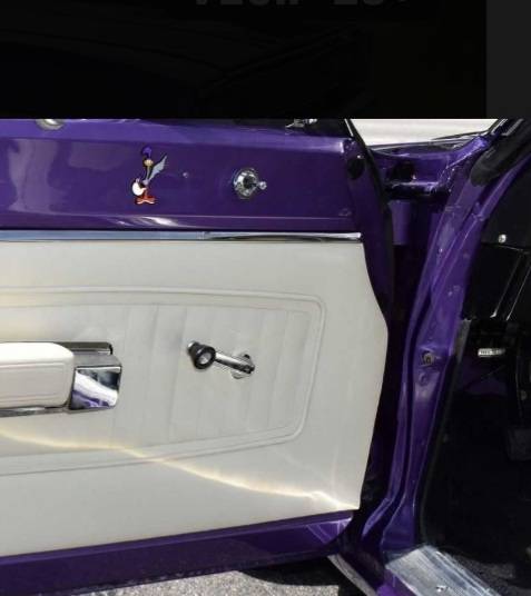

I need to know where to drill the hole in the interior panel to locate the remote and if I have the correct bezel. Pic for reference, not my car.

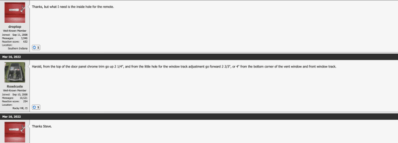

Need a measurement
As far as the diameter of the hole goes it should be simple. Check the diameter of the part of the mirror the bezel screws on to and drill it that size.
