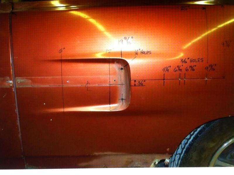

I am looking for a measurement or schematics for the location of the "roadrunner" call out on the rear quarter panel of a 1970 roadrunner. The car I have had had quarters put on it and there are no hole locations. Can anyone help? Need spacing on the holes as well as exactly where the fall on the quarter behind the scoops. Thank you
IMG_5448.jpg Is this what you're looking for?
