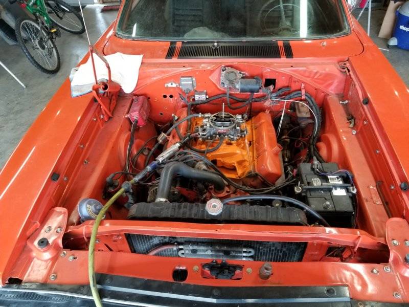

I call it more of a redo than restoration since most of it is going back and fixing stuff right that wasn't done in its first "Restoration" by previous shop. It was a Bare Bones EV2 383 auto on column with hood treatment car.
The day we picked it up.

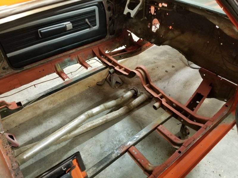

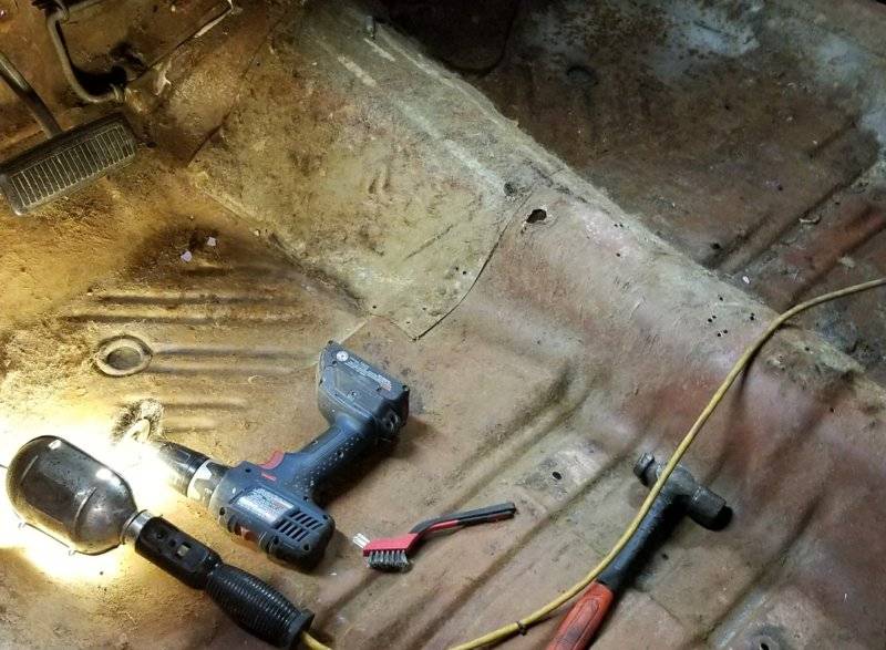

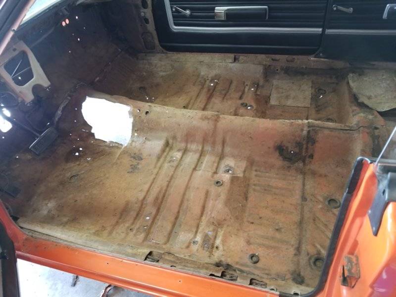

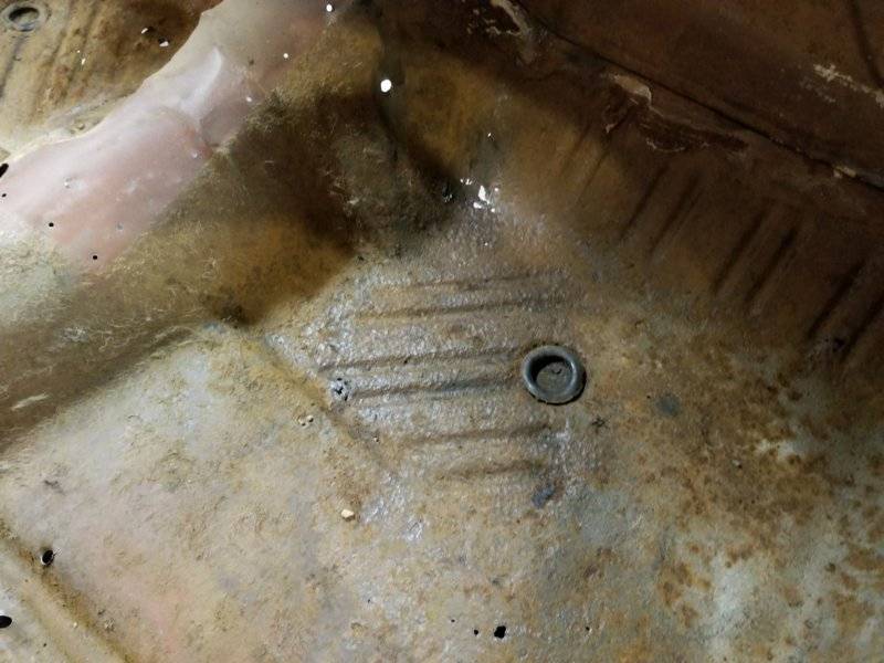

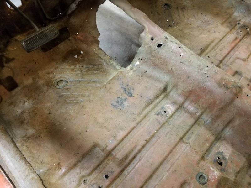

Next the rest of interior came out. The car is not rusty but was hacked up at some point and a 4 speed ran in it. Then the bench replaced with buckets. They did not reinforce for the buckets and ruined the floor.

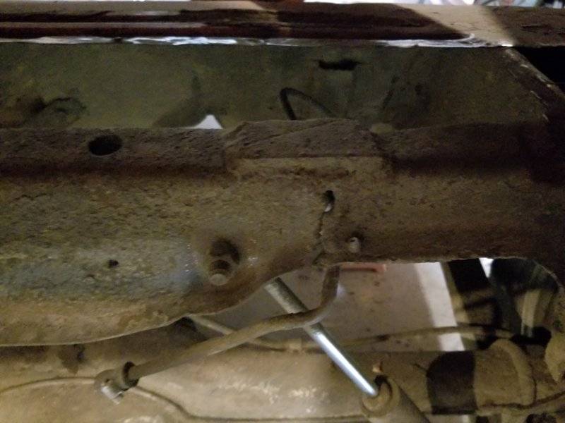

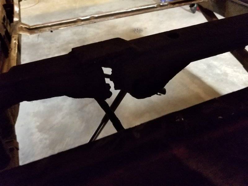

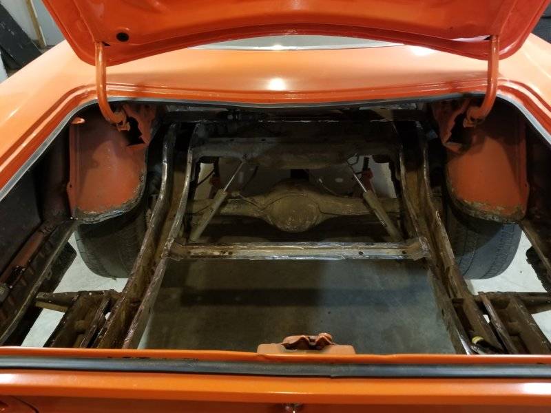

I then went to trunk area the Rear Shock crossmember had broke and someone "Repaired it" They cut a hole out and welded 1/4 plate on top. then covered it back up

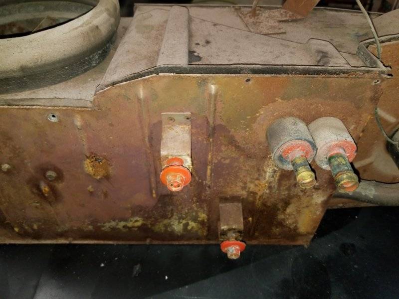

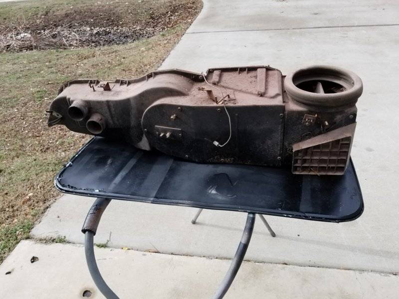

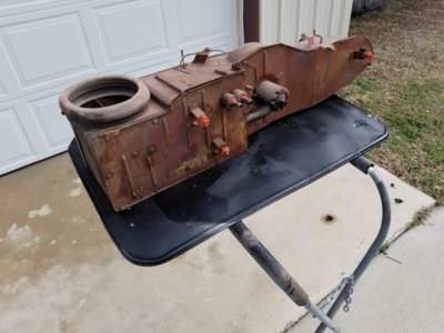

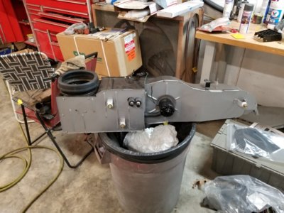

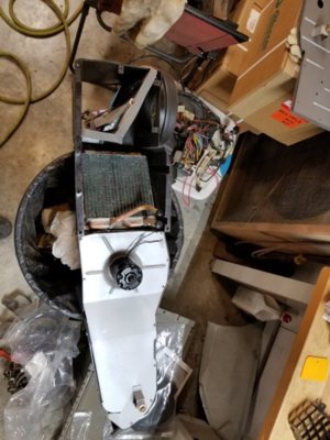

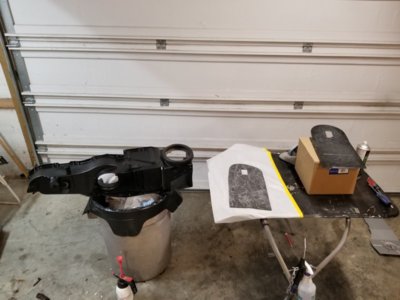

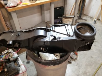

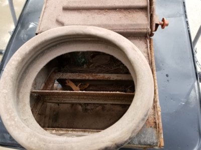

Got Heater box done. I tried 3 Different replacement heater cores even one of the OER from classic none fit. I sent mine to Glenrays Radiator Perfect job had it less than a week.

Looks like you are fixing it right, and that's great. The shock crossmember probably broke from someone jacking it way up with air shocks.

I'm thinking of getting my heater core reconditioned as well. That looks like a great job they did for you.

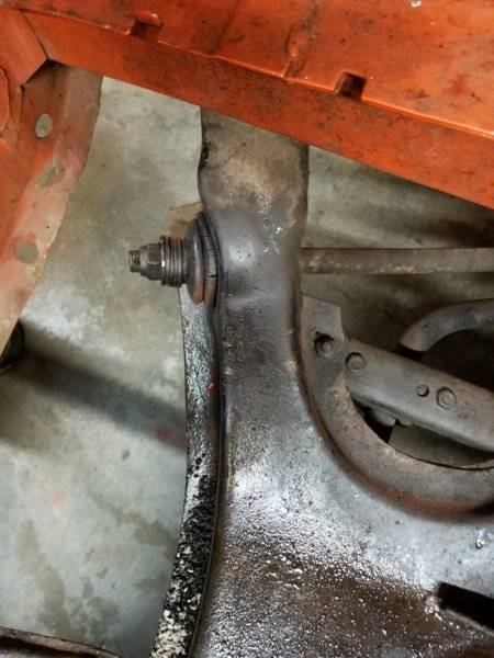

what was wrong with the K?
what was wrong with the K?[/QUOTE

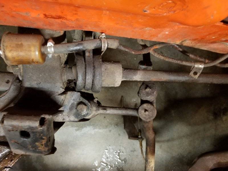

On the passenger side where the strutted mounts looks sucked in to keep its asham cause it has the skid plate on it for the 440 or hemi k member
