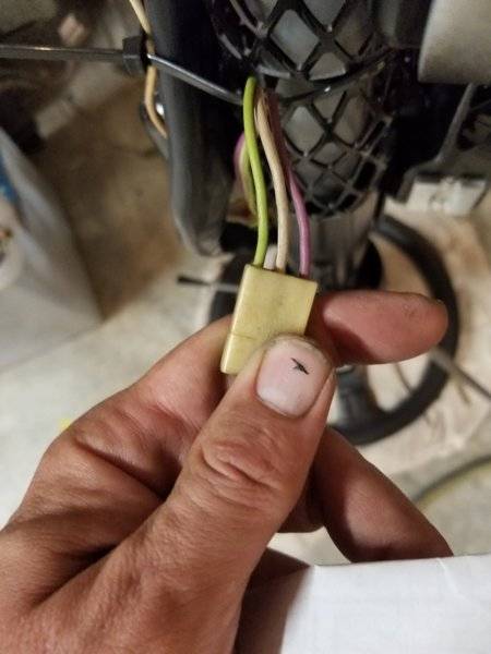

Trying to figure out the harness on column have new ignition harness and good turn signal harness. Have the ahift indicator light and one other plug to figure out. The indicator has a single yellow wire coning from it.
You have a replacement C-body turn signal switch. Pictured connector is for cornering lamps, disregard for other models. Single yellow wire connector is for the ignition lock lamp.
