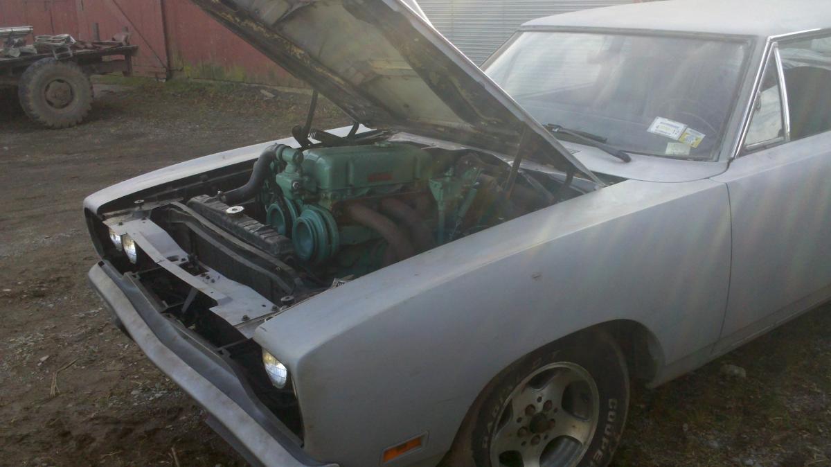

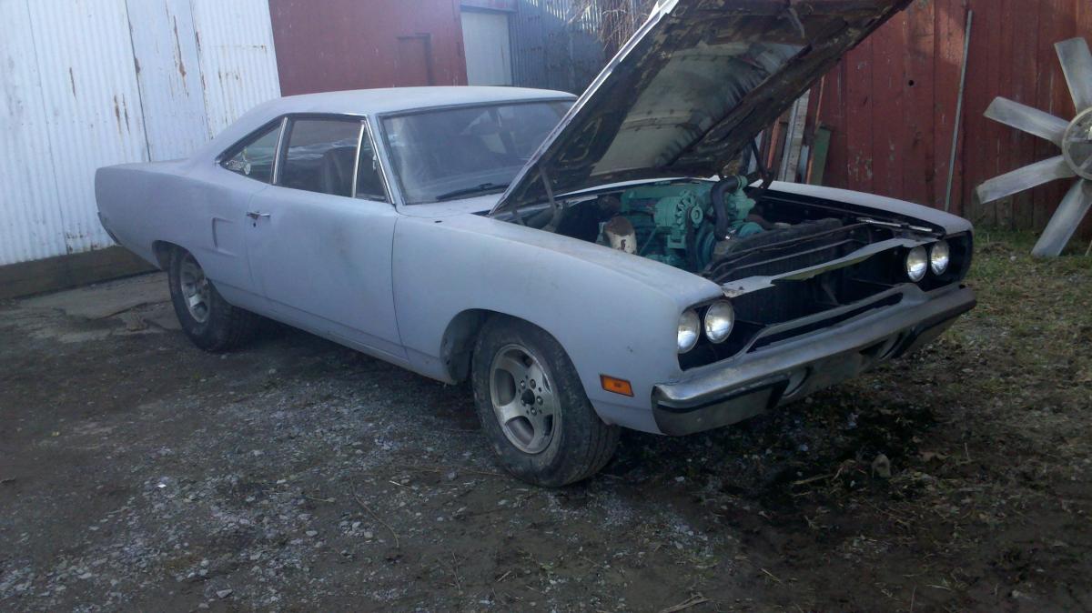

Check this out- I went to look at some Mopar stuff a guy was selling today and was stunned when I saw this. It's a 70 Roadrunner, but the guy replaced the 383 with a 3 cylinder Detroit Diesel!! It runs and drives, and uses a Mopar 4 speed! I just had to share...

I definitely wouldn't do it myself, but I respect the engineering that it took to get the 4 speed to work like it does. The same guy showed me his mid 80s Dodge van- it has a 5 cylinder Mercedes diesel in it.
I've seen DuraMax mills in Camaros and Mustangs, why not this? Gotta admire the guy's creativity and fabrication skills. Thinking outside the box? You can't even SEE the freakin' box! I love it!

thats cool, hard to tell from the pics, is it turbo/super charged? is it 2 or 4 stroke? is it electronically or mechanically injected? Closest thing I've seen to that is a detroit 6V-71 ( 6 cyl, V configured, 71 CI per cyl, 2 stroke, supercharged) in an old Ford pick up. I think it's neat, If he would have put a chevy engine of some sort in it, I would be pissed, but that is cool.

Interesting project, I suppose. He won't be pulling 10's in that car any time soon...man that's a 3-71 jimmy...they ran a whopping 110 HP at about 9000 rpm....
To each their own...what ever blows your hair back...beefing up the front end to handle a 1500lb motor would be interesting though....

man who knows more about Detroits than me right here. So it's a 213 CI engine that came out of a GMC truck. 9000 RPM, so I assume it is 2 stroke.
All the 71 series engines were 2 stroke...9000 Rpm was a saying we had in the day...'slam your hand in the door, then drive it....drive it like you hate it"...

This car was built very recently, not in the 80s! The owner told me that top speed with 3.23s was 55 mph, so he swapped in 2.7s and tall tires and now the 100hp diesel has a top speed of almost 70mph.
Again, I wouldn't do this swap myself, but I didn't see anything that couldn't be undone (except the hood). The engineering is slick; it uses a Mopar 4 speed with the stock mount in correct location, and stock driveshaft. The Mopar pressure plate is inside the diesel bellhousing with a homemade adaptor to mount the trans.
