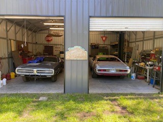

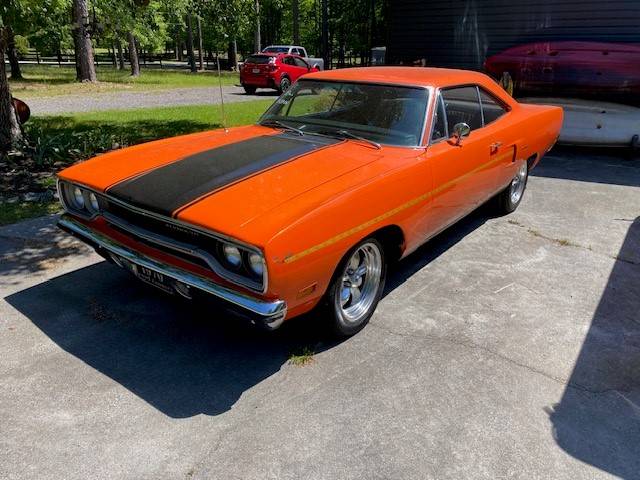

Hey guys. Just picked up a nice 70 Roadrunner but it has drum brakes on the front. I have a 72 charger parts car that has disc on the front. Can I swap them?

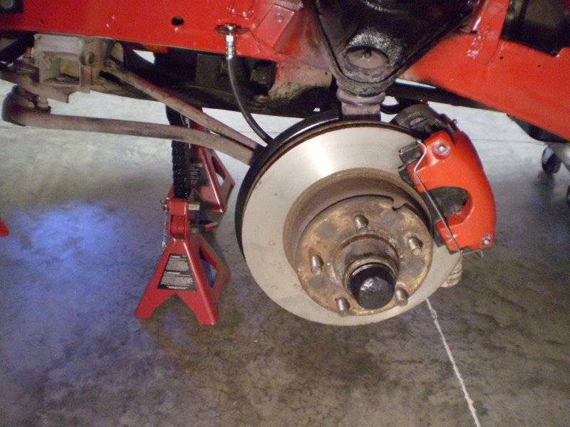

Yep, that is the same set-up that was optional on the 1970 RoadRunner. Single piston caliper with round slider pins. I have this exact conversion on my 1964 Polara. They actually came off a 1970 RR about 40 years ago. The spindles are interchangeable side for side. I hung my calipers at the rear, so they would not interfere with my sway bar. Get the master cylinder and brake block with proportioning valve as well. I noodled this out before any of the Mopar magazines were putting out articles aout disc brake conversions. I had to move the brake line bracket ahead of the A-arm from behind it.
