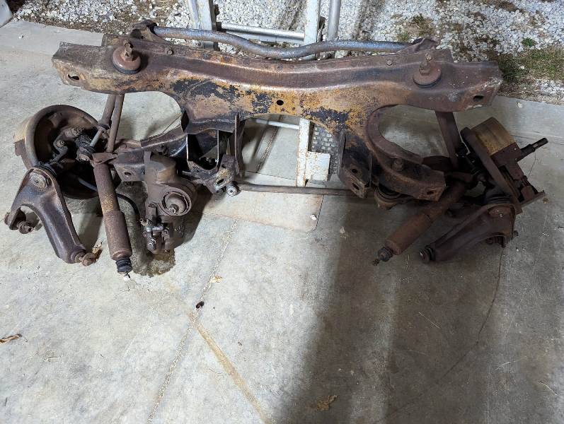

My 70 is a 10-69 build date at L.R.M...maybe they used parts they had left over ???? The green 70 is identical to the 70 R/T front I picked up.. firewall, inner fenders, k member, suspensionTop pic looks like 69. Calipers to the rear on that.
Bottom is 70 and up, calipers to the front.

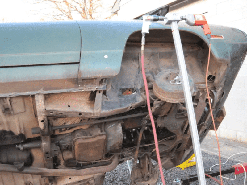

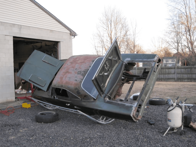

got it from here ...There are some sketchy ways to work under a car but that looks really strange.
I don't know what that means.
That "jack" in the picture looks extremely unsafe and UNsmart!
Thank You ! ..that cleared the fog ...lolTop pic looks like 69. Calipers to the rear on that.
I didn't want to ask, but good on ya![]()

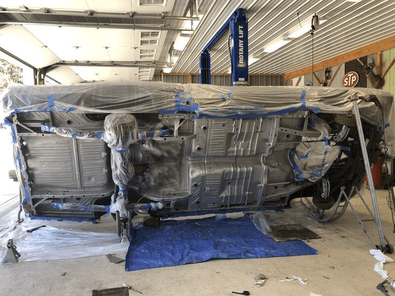

The man has a two post lift, yet he chose to use that weird stuff to roll the car on the side??
DUNNO.. ?The man has a two post lift, yet he chose to use that weird stuff to roll the car on the side??
I have been looking for a 66 to 69 sway bar set with control arms if you'd like to sell?these are not mine but these are the ones I have that are disassembled ... the location & size diff is evidentView attachment 1666898View attachment 1666897
Shoot ..I wish I was further along on my 70,as I have not made my mind up yet on which set up I will use. When I do I WILL contact you ...both sets of control arms have the stiffening plate welded on alsoI have been looking for a 66 to 69 sway bar set with control arms if you'd like to sell?
