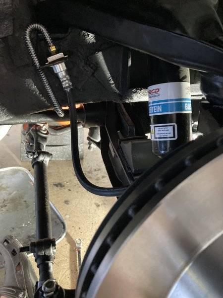

Could not find a decent pic anywhere of stock hoses so here we go. They are not stainless but look exactly like setup in disc o tech article and clear everything. Not bad!
Update: Shakedown issues yesterday but today out on the road and it stops MUCH better than front drums. It literally feels like a barely touch brake older 80s luxury car. Not like modern discs but how I remember cars of that era. Very much worth the effort.
