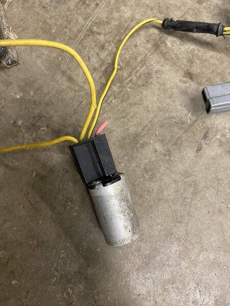

Please help me. I have an unknown critter or
flasher or something. Can anyone tell me what this is?
I think it is a time delay relay, I haven't worked on those years cars since they were new.
Mike
time delay relay for the ign switch courtesy light ( also for seatbelt light on 71s )
it got missed the pink wire what runs to a batt source ( fuse box on any batt feed along the harness.
It gets the door jam ground switch signal to trigger it and feeds the bulb into the column, underneath the hazzard knob
ah ha!!!!! So that is where that yellow wire hanging from the steering column go, I guess. One down, a couple more stray wires to go!!!
Thanks for the replies!!
