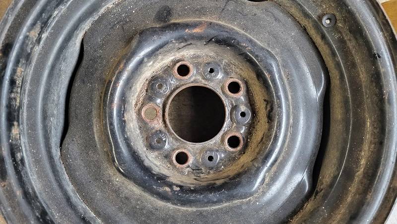

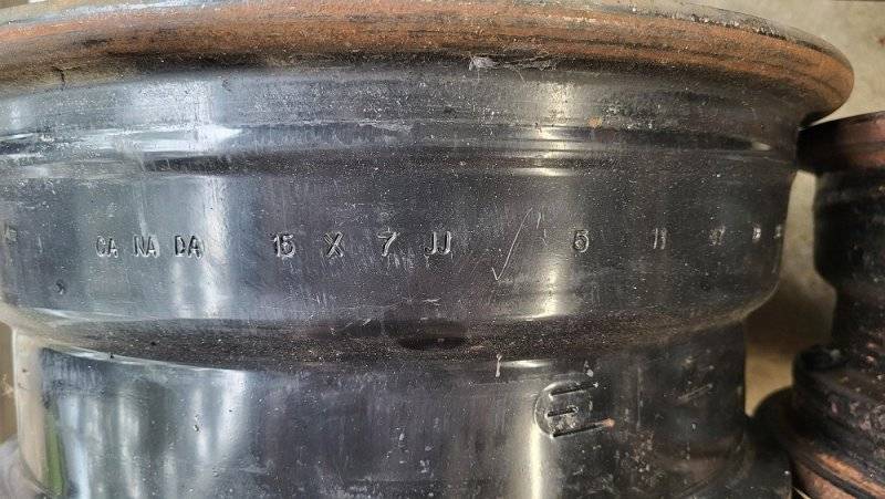

Can someone please help me to identify this 15X7 JJ rim and/or tell me if it has any value?
Thanks,
Ken
Looks like a late 80's Ram Charger. What's the date on it? looks like 5 11 87
No it is not. 81 and newer ramcharger had the larger hole and the 5 1/2 bolt circle.
Ok Thanks for the correction I am not a 80's truck guy.. But I thought they used a wheel like that on Trucks and Ram Chargers.. Date will tell us.
4x4 75-79 trucks and ramchargers, traildusters had the small car bolt pattern
Dodge Diplomat. Saw them all day long in the yards in the 90's. Look at the center between the lug nits, raised round area with a small hole.
Didn't trucks carry the smaller bolt pattern later on into the early 80's? Just curious...
No. 80 and newer 4x4 all were 5 lug 5 1/2 bolt circle. 2wd did have the smaller pattern.
Ok Yes 2 wheel drive TRUCK was what I was talking about cause I remember using a spare wheel from an early 80's dodge truck for a spare car trailer tire that I got my rust free step side bed from for my 78 step side 4x4 I had......
that is off, diplomat or Chrysler Town and country from the '80s. Five on four and a half ...rear wheel drive car....!!!
Just to add to your list.
72-84 (MID YEAR) had 5x4.5 in the D100/D150
84-93 is 5x5.5 in the D100/D150
W's 4X4's like you said where 5x5.5
