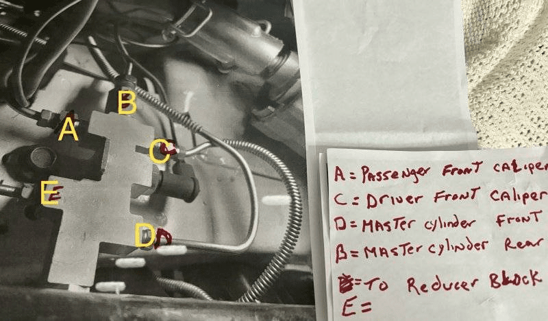

I took a photo of the proportion valve connections. Do they look correct?
people are saying do you have the front and rear connections reversed on the master cylinder?

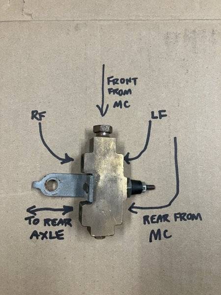

This is yours:
This is a distribution block but the respective ports are in the same general location.
We have it described differently but I think we mean the same thing. I automatically default to thinking the frontmost port on the MC is for the rear but this isn't the case in every application.

I know I'm a bit late to the discussion but Kern Dog is right you have your lines into the proportioning valve switched. Until that is resolved nothing will act as it should. The front takes a lot more fluid pushed through the system to operate (front brakes = 80% of braking power) and your trying to feed it with small chamber of MC. Once lines are corrected power bleed the system (about $60 at Amazon or Summit) to get all air out and you should get a good pedal. While I don't think its part of your main issue the rear brake hardware is a mix and match and you should be replaced - Hardware kit is $15 at Rock Auto, get the one that has complete hardware including adjusting screws. If this helps please post results so others can benefit.
