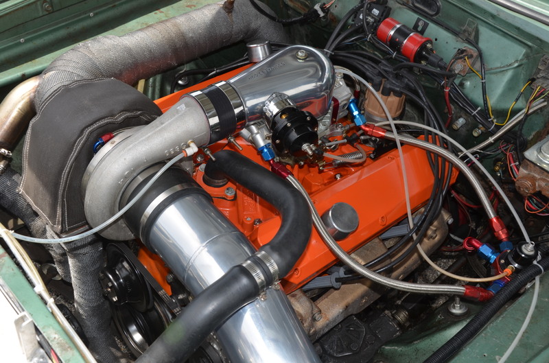

If you can wait we are going to market small block turbo kits. This one runs 9.80@137, 3800lbs on only 15psi. Carb, no intercooler, 3.55 gear, street driven. Stock 360 block and crank. Ran 10.30's with factory heads and cam.

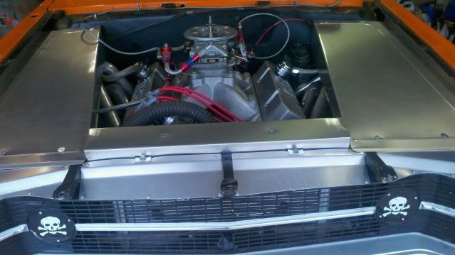

400 based 4.15 stroke in my 68 Dart/
400 pass's on stock block prepp'd by Muscle Motor's.
Used Indy SR heads
Over 800 hp
Chassis is for sale check out for A-body's web site for details.
Cert to 8.50
Went to a 7.50 car.

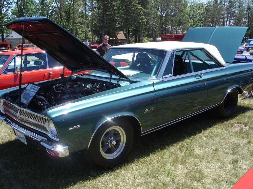

Your car is mighty fine! Taken at Mopar's in the Park '09.
